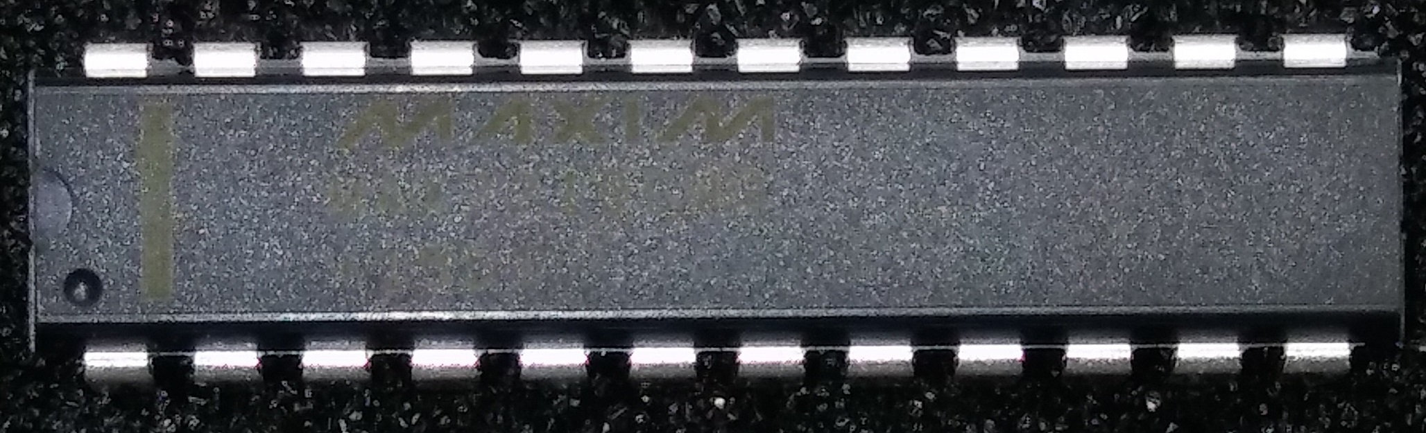

Hi, maybe you can help shed light on a weird problem, I have a Sparkfun pro-mini running a single MAX7219 on a prototype board I had made. It has run fine, i.e. days. I built a 3rd board and all of the segments LED's were on full brightness, even though I used the same 30k ohm for Rset as the other two boards I made. The software can't put the MAX7219 to sleep, it just stays on. When the code runs, all you can see is a very slight dimming of the segments. Adjusting brightness in the code had no effect.
All of the 7219's came from Sparkfun and they appear legit. I soldered the chip in at 500F, which is less than the 300C recommended limit for 10 sec.

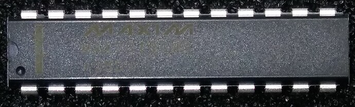

Can you post a close up well focused picture of the Max 7219 chip?
I'll attached a photo of the chip I'm using, it is the MAX7219 CNG. It contains a "+1551" label beneath

Your max7219 looks like the genuine article, made by Maxim. There are many cheap copies around. Most users find that the copies work perfectly, as I have myself, but occasionally there can be problems
figured it out, and it's ridiculous!
I started building a new board with sockets for everything, and was studying the schematic and realized that I had soldered all of the LED's backwards; which I confirmed by applying a power source to an LED and observing they were lighting up the wrong way.
