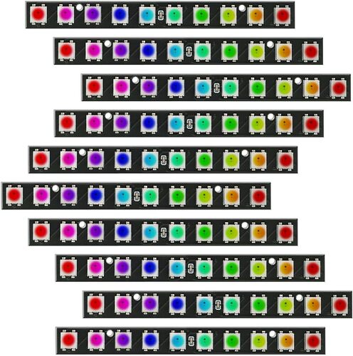

A Neopixel matrix can do that without a wiring cobweb.
Not cheap though.
Leo..
These pre-made 8x5050 sticks are nice for about US$20 for quantity 10. I did NOT name them.
