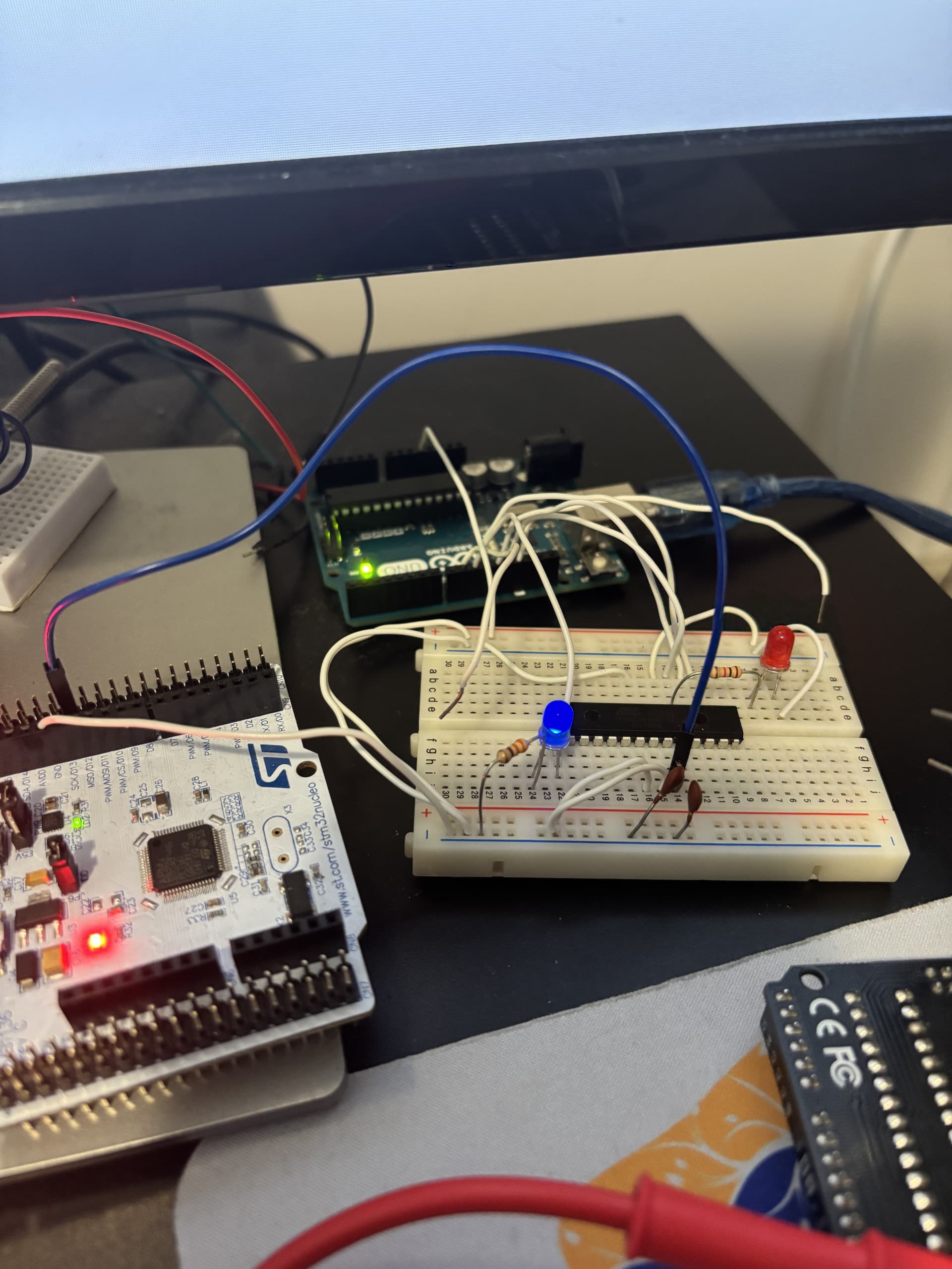

I thought it may be a clock issue, so I jerry-rigged a crystal oscillator, but when I went to burn a bootloader, it just stopped working (I can tell because my blinking LED stopped in its last on or off state). I also used a spare STM32 to generate a ~2MHz square clock; it halts as well. To ensure it wasn't a wiring issue, I took the chip out of the (clone) Arduino socket and used a breadboard to program it. I used spare LEDs to visualize the ISP connection. It was clear that the programmer sent a MOSI, but the target was not returning a MISO.

Crystal Oscillator (jerry-rig)
STM32 square clock

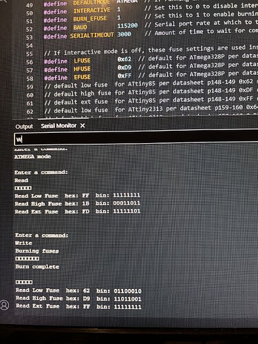

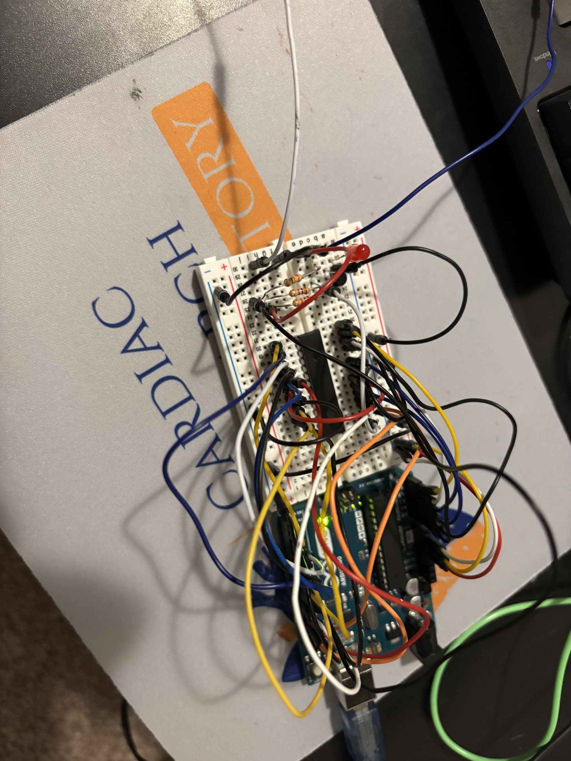

Simply brilliant! And I didn't even break a sweat! Your instructable worked on the first try. Turns out the culprit fuse was RSTDISBL. I accidentally disabled the external reset, which explains why I couldn't upload code or get the square wave clock working. Thank you!
Some victory photos:
HV Rescue Setup:
Fixing Fuses:
