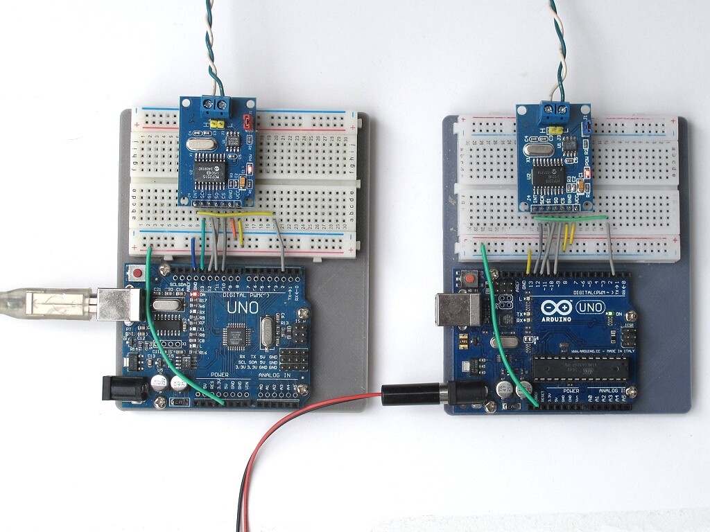

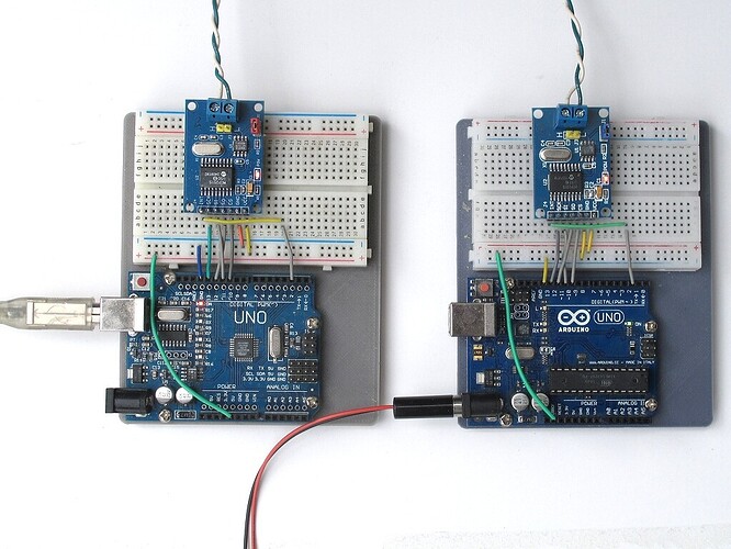

Hi all,
I'm working with two MCP2515 CAN modules connected to Arduino Uno boards one as sender, one as receiver. Wiring is okay — MISO, MOSI, SCK, CS, are properly connected. CANH and CANL are linked between both modules, with 120Ω termination resistors at each end. Ground is shared. I'm using the "send" and "receive" example codes from the `mcp_can` library.
The sender shows:
 ![image](https://europe1.discourse-cdn.com/arduino/original/4X/3/0/6/3065ec62b39a39c307b124a054e4c551831bdf9f.jpeg)
The sender shows:
> Message Sent Successfully!
But the receiver continuously shows:
> Standard ID: 0x000 DLC: 0 Data:
Even though I expect messages with ID `0x100` and 8 bytes of data.
While debugging, I noticed the following line in both sender and receiver code:
> CAN0.begin(MCP\_ANY, CAN\_500KBPS, MCP\_16MHZ);
However, on inspecting the MCP2515 module, I realized the crystal oscillator is actually 8 MHz, not 16 MHz. so I changed it to:
> CAN0.begin(MCP\_ANY, CAN\_500KBPS, MCP\_8MHZ);
but I still get `ID: 0x000` with zero-length data on the receiver.

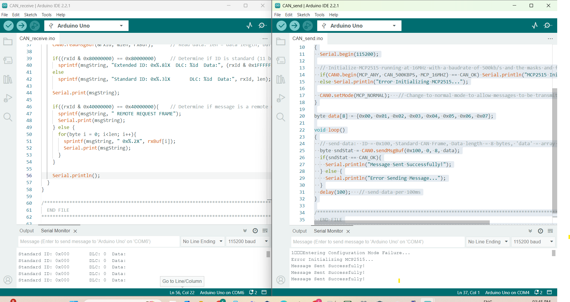

I'm attaching a snapshot of the receiver’s serial output below.
 ![image](https://europe1.discourse-cdn.com/arduino/original/4X/4/1/0/41033b2100fa1e3d4bfeec4dd20b8a2f204fe3ea.png)
When I connect int pin receiver show
 ![image](https://europe1.discourse-cdn.com/arduino/original/4X/0/8/e/08e4cc680e892a6022feb07c6a46b6b4ac4fce4b.png)

your transmitter reports
 ![image](https://europe1.discourse-cdn.com/arduino/original/4X/f/4/4/f44e137b96c688e9b5f30ef07acd2bc0a47514a0.png)
looks as if it has not initialized correctly - check your wiring?
avoid posting images of text? they waste space and the text cannot be copied
copy the text and paste using code tags \< CODE/ \>

in the screen images in post 1 the receiver appears to initialize Ok but the transmitter fails with error message
 ![image](https://europe1.discourse-cdn.com/arduino/original/4X/e/c/5/ec52ea4f06a230eee126627388ebba42bee93f7c.png)
but then goes on the print that messages are sent successfully
initialization failure generally indicates something is wrong and I would not attempt to use a device

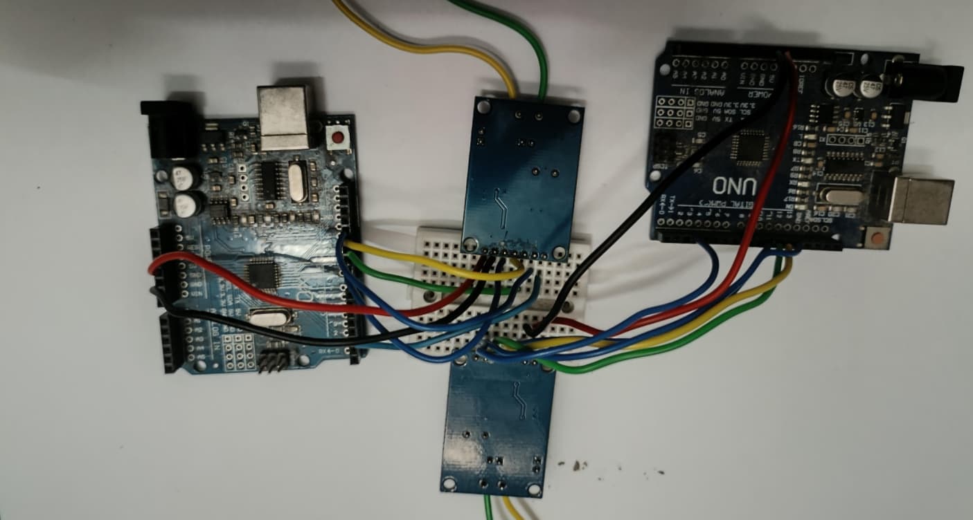

I connected one UNO with an MCP2515 module and uploaded the loopback sketch. Even though it printed “Initialization Failed,” it still went on to say “Message Sent Successfully!” which doesn't make sense. If the init really failed, how is it still sending? Makes me think the code might be printing that without actually checking the result properly.
I tried the same with a Mega and another MCP2515, and saw the same behavior.
In fact, I’ve tried so many combinations, swapping boards, modules, and wiring and I still get the same behavior. So it really feels like the example code is just printing that message without properly checking if the message was actually sent.

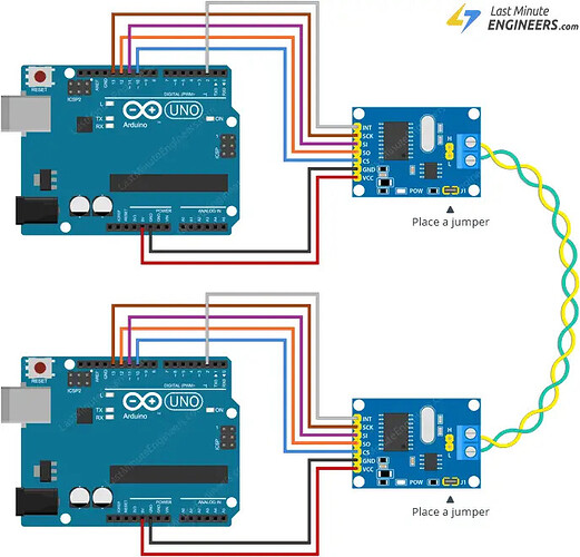

> post an annotated schematic showing exactly how you have wired this and if possible a clear photo of the transmitter and receiver units.

> [@adrino1](#):
> I followed the exact same connection as shown there, including placing the jumper on both MCP2515 modules for 120Ω termination.
That may be what you thought you did. But it may not be what you actually did.
I just loaded your sender and receiver sketches into 2 Uno R3s with MCP2515 CAN modules wired up as shown in the Last Minute Engineers picture. Here is a photo of my actual setup.
 ![MCP2515s Rx on left, Tx on right](https://europe1.discourse-cdn.com/arduino/original/4X/5/4/1/54113aadebfecf86740ce39e903742b3f785b218.jpeg)

Connected the receiver up to my PC, started up a terminal program and applied power.
And it worked like a charm.

So what can we conclude?
One conclusion would be that your setup does not match what the Last Minute Engineers picture shows. Why? Because my setup did, and it worked. Therefore, there must be something different in your setup. Either your wiring is incorrect, or you have a bad module. A photo of your actual wiring would allow eliminating one possibility. That's why you're being asked to show it.
This is all to say, this is why you don't show what someone else has done that works when what you have done doesn't work.

Thanks to all of you, really appreciate the support and patience until the problem got solved
So I think we can finally conclude the problem was with the bad quality of jumper wires. I removed all the connections and placed the MCP2515 modules on a breadboard. Then I connected the UNO and MCP using solid core wires. After that, I uploaded the sender sketch to one UNO and the receiver sketch to the other, and now I believe I’m finally getting the expected output on both ends.

I’m attaching a snap of my setup too. I know it’s a bit messy and hard to follow . The header pins on my modules are facing upward, so you can’t really see the labels on the MCP2515 itself.
