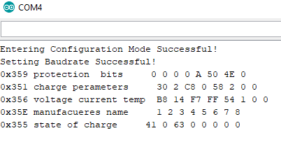

I've written some code that converts RS485 to can bus, I've loaded this code onto a Uno with the usual generic Can bus transceiver shield together with a simple bit of code again using mcp\_can.h and its basically working except it will only send 5 of the 6 data packets, I'm really not sure if the is an issue with the transmitter or receiver, following is the part of the transmitter code isolated from the main body to make it more readable;

![image](https://europe1.discourse-cdn.com/arduino/original/4X/b/c/6/bc65a59fe0ce5761ea615c5ba3c18518e3a6bfe2.png)

So sorry, I did uncomment that line, I was trying to force it to send 0x365 by only sending 5 packets but didn't attach the modified code hence the image of the serial monitor not matching the TX code, my bad.
Here is the actual code;

  //--------------------- untimed code -------this runs with every loop -----------------
  //------------------------------end of untimed code -------------------------------------------
  if (currentMillis - previousMillis >= interval) {
    // save the last time you blinked the LED
    //----------------------------- timed code, this code runs once per second --------------------------
    canbusSend(); // send can bus message to inverter
    //---------------------------------- end of timed code -------------------------------------------
//================================= end of main loop ==================================================
//================================= subroutines =======================================================
void canbusSend() { // ---------- send can bus message to inverter ----------------------------------
  //--------------------------------------- packet 1 ------ protection bits --------------------------
  addressID = 0x359; // (flags) set as per pylon protocol
  CAN_MSG[0] = 0x00;
  CAN_MSG[1] = 0x00;
  CAN_MSG[2] = 0x00;
  CAN_MSG[3] = 0x00;
  CAN_MSG[4] = 0x0A;
  CAN_MSG[5] = 0x50; // sends ASCII 'P'
  CAN_MSG[6] = 0x4E; // sends ASCII 'N'
  CAN_MSG[7] = 0x00;
  sndStat = CAN0.sendMsgBuf(addressID, 0, 8, CAN_MSG); // send flags
  //----------------packet 2------- charge / discharge voltage current temperature-------
  addressID = 0x351;
  CAN_MSG[0] = 0x30; // 0x30
  CAN_MSG[1] = 0x02; // 0x02
  CAN_MSG[2] = 0xC8; // 0xC8
  CAN_MSG[3] = 0x00; // 0x00
  CAN_MSG[4] = 0x58; // 0x58
  CAN_MSG[5] = 0x02; // 0x02
  CAN_MSG[6] = 0x00; // not used // 0x00
  CAN_MSG[7] = 0x00; // not used // 0x00
  sndStat = CAN0.sendMsgBuf(addressID, 0, 8, CAN_MSG); // send limits
  //-------------- packet 3---------- state of charge, state of health -----------------
  addressID = 0x355;
  CAN_MSG[0] = 0x41; // 0x41
  CAN_MSG[1] = 0x00; // 0x00
  CAN_MSG[2] = 0x63; // 0x63
  CAN_MSG[4] = 0x00;
  CAN_MSG[5] = 0x00;
  CAN_MSG[6] = 0x00;
  CAN_MSG[7] = 0x00;
  sndStat = CAN0.sendMsgBuf(addressID, 0, 8, CAN_MSG); // send state of charge
  //------------------- packet 4 --------canbus send voltage current temperature-------------
  addressID = 0x356;
  CAN_MSG[0] = 0xB8; // packVoltageLowByte; // 0xB8
  CAN_MSG[1] = 0x14; // packVoltageHighByte; // 0x14
  CAN_MSG[2] = 0xF7; // packCurrentLowByte; // 0xF7
  CAN_MSG[3] = 0xFF; // packCurrentHighByte; // 0xFF
  CAN_MSG[4] = 0x54; // packTempLowByte; // 0x54
  CAN_MSG[5] = 0x01; // packTempHighByte; // 0x01
  CAN_MSG[6] = 0x00;
  CAN_MSG[7] = 0x00;
  sndStat = CAN0.sendMsgBuf(addressID, 0, 8, CAN_MSG); // send Volts Amps and temp
  //---------------- packet 5 ----------charge request flags----------------------
  addressID = 0x35C; //
  CAN_MSG[0] = 0xC0; // this byte used only as per *
  CAN_MSG[1] = 0x00;
  CAN_MSG[2] = 0x00;
  CAN_MSG[3] = 0x00;
  CAN_MSG[4] = 0x00;
  CAN_MSG[5] = 0x00;
  CAN_MSG[6] = 0x00;
  CAN_MSG[7] = 0x00;
  sndStat = CAN0.sendMsgBuf(addressID, 0, 8, CAN_MSG); // send protection bits
  //-------------packet 6 ---------canbus send manufactures name----------------------
  addressID = 0x35E;
  MSG_RustyK[0] = 1;
  MSG_RustyK[1] = 2;
  MSG_RustyK[2] = 3;
  MSG_RustyK[3] = 4;
  MSG_RustyK[4] = 5;
  MSG_RustyK[5] = 6;
  MSG_RustyK[6] = 7;
  MSG_RustyK[7] = 8;
  sndStat = CAN0.sendMsgBuf(addressID, 0, 8, MSG_RustyK); // send manufacurers name
The serial monitor is showing only 5 of the sent 6 packets, what ever I do it refuses to send / receive all 6, I'm wondering if I've reached the limit of either the TX or RX buffer?
Edit, I've added a 10mS delay after sending each packet, I now seem to be receiving all 6 data packets.

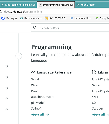

It's Serial.flush(); It's in the language reference on this web site.
