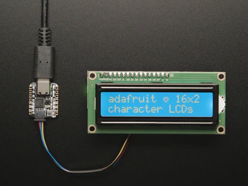

The Adafruit i2c board uses this chip.
See this project:
The adafruit library is LiquidCrystal compatible but you will have to modify
the pin mappings in the code since the board you have doesn't map the pins the same.
(The adafruit code does not allow configuring the pin mappings from the sketch).
FalconFour's code is much faster but hardcoded in a way that is more difficult
to modify the mappings.
I'm in the process of creating an addition to fm's new LiquidCrystal library to support this chip.
I'm not quite finished with it.
--- bill
