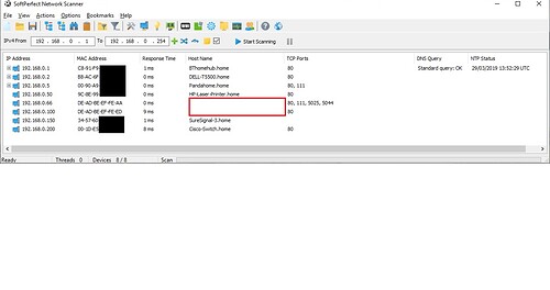

You are correct, and I need to revise what I'm saying. I need mDNS/Bonjour to report a .local network name. I need the device regardless of DHCP or Static to still display this name. I want all trace of WIZNet-mac to be removed from all naming protocols (DHCP-ID, Bonjour/mDNS name, (reverse) DNS name, WINS name, etc).
Hardware is: STM32F103C8T6 and W5500 connected via SCP.
Open ports for TCP and UDP are: 80, 111, 5025, 5044
Bellow is what I currently see, or the red box is filled with WIZnet-mac. I want it to report the name of my choice. |500x264
Do you need it exactly for that scanner? As far as I found information on the Net about this scanner it uses a proprietary algorithm to get these "Hostname"s, so it might do several things and display any name. Ask the vendor about what exactly the scanner does in what order to be able to provide the correct name for that scanner.

Well with your help Pylon, I have resolved the issue, I modified the Dhcp.cpp and Dhcp.h files in the Ethernet_STM as follows:
.cpp file
 // OPT - host name
    buffer[16] = hostName;
    buffer[17] = strlen(HOST_NAME);   //was buffer[17] = strlen(HOST_NAME) + 6;
    strcpy((char*)&(buffer[18]), HOST_NAME);
    //printByte((char*)&(buffer[24]), _dhcpMacAddr[3]);
    //printByte((char*)&(buffer[26]), _dhcpMacAddr[4]);
    //printByte((char*)&(buffer[28]), _dhcpMacAddr[5]);
.h file
#define HOST_NAME "My-Required-Name"        //ORIGINALLY #define HOST_NAME "WIZnet"
And also using within my arduino app for mDNS:
EthernetBonjour.begin("My-Required-Name");                        // Initialize the Bonjour/MDNS library, always call this before any other method!
EthernetBonjour.addServiceRecord("My-Required-Name._http", 80, MDNSServiceTCP);
EthernetBonjour.addServiceRecord("My-Required-Name._vxi-11", 111, MDNSServiceTCP);
All is working perfectly, and with every search app the correct data is displayed.
