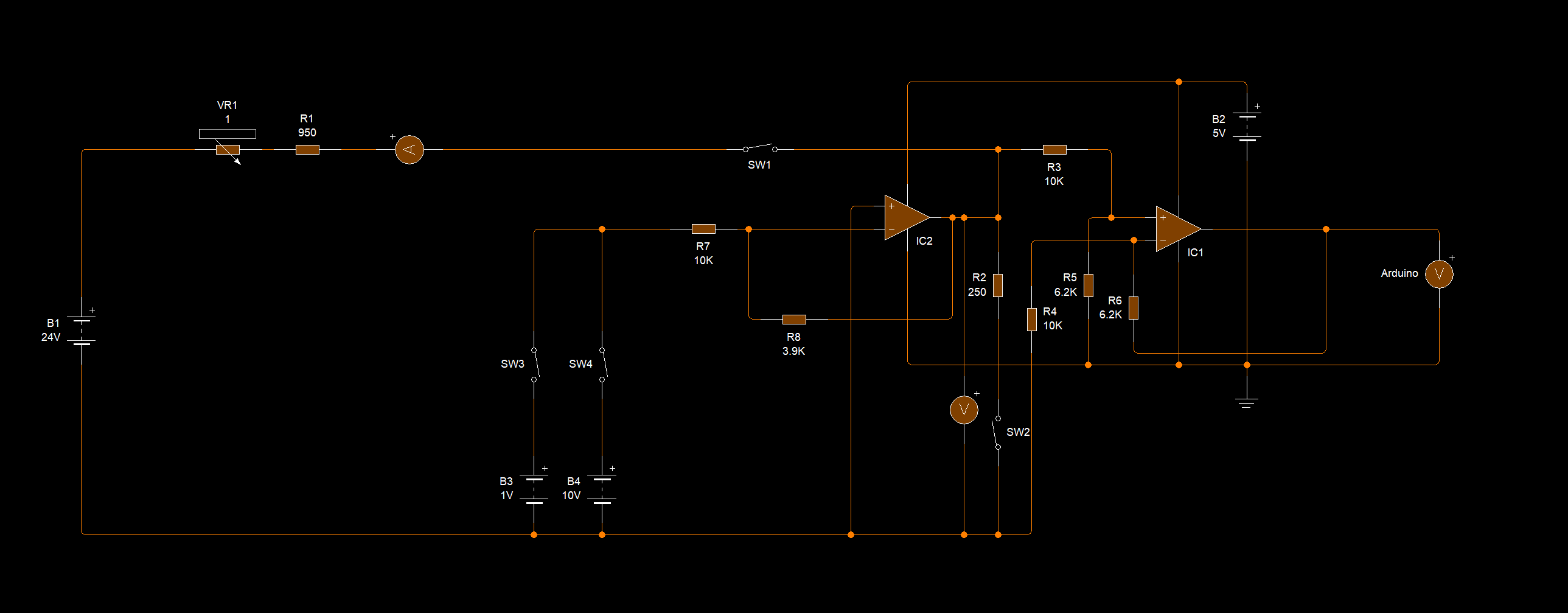

Hi, I want to make a data acquisition system with two input channels: CH0 for 4-20mA and CH1 for 0-10V. Both signals have separate grounds, and I want to isolate them from the Arduino's power ground. I’m not sure what keywords I should search for on Google. Has anyone ever made something like this? If so, please tell me how to do it.
Please show more information (circuit diagram) on this essential detail of your project.

Here my schematic diagram, B1, VR1 and R1 to simulate current signal 4-20 mA. B3 and B4 to simulate voltage signal 0-10V. I want design circuit that can measure either current signal or voltage signal. in the right side I use volt meter to simulate arduino

Yes I do use resistor to drop the current signal so I can measure it as a voltage. So basically I need to measure voltage signal with isolation grounding from arduino.
I guess you never intend that switches 3 and 4 are never both closed at the same time.

Yes, switch 3 and 4 to simulate a voltage signal at 1V and 10V so I can get a picture of the output.
It does not make clear your separate grounds problem. Are the opamps really required for clarification?
You will need to use analog optoisolators such as the LOC110, HCRN200 or IL300. You will also need two isolatod power supplies, one for CH0 and one for CH1.

Whatever, maybe this crude addition to your schematic , together with a bit of ohms law, helps to get a common ground between the measuring points:

Either the signals are isolated from each other or already have some interconnection. If all cases shall be considered then two fully isolated ADC are required, together with e.g. UARTs and optocouplers to the common base station. Such solutions have been discussed already. Any simplification depends on more/better knowledge of the electrical dependencies between the sensors.
This would work , provided the supplies were all batteries. What would happen in practise is that the grounds would float until they reached a level compatible with each other.
But you are only simulating a small part of the problem, and there are MUCH easier ways to do that - all you need is a battery (to provide the 0-10V signal) and a resistor (to manage the current).
However you CANT use a difference amplifier (IC1) to provide electrical isolation.
