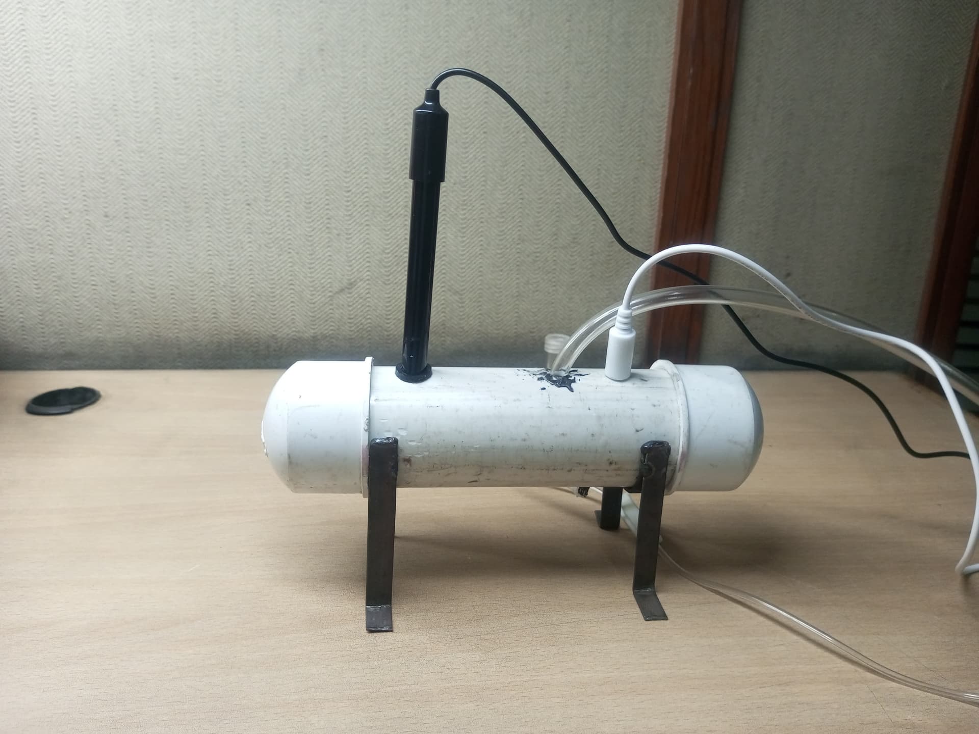

I'm working on a system to measure the pH of water tanks located in remote areas. I only need to take measurements 3–4 times per day, but I'm concerned about the longevity of the pH electrode.
Here are the constraints and current ideas:
  1. Continuous immersion
If the pH electrode is left immersed in the tank water (which is not clean but not highly contaminated—think of rainwater runoff), it may degrade faster due to fouling or long-term exposure.
  1. Sampling Pot approach
One idea is to use a small sampling chamber that fills with water from the main tank every 6 hours. The measurement would be taken from this small pot, which is then flushed and emptied. However, I'm unsure whether this setup would help.
I came across a helpful video from Hanna Instruments about common mistakes when using pH probes: https://www.youtube.com/watch?v=OXPAXNILHu8
What would be the best practice to implement reliable and long-term pH monitoring in this scenario? I'm looking for suggestions that balance electrode lifespan, accuracy, and maintenance effort.

The locations are situated in hilly areas, and I'm using LoRa gateways to collect the data, which is then sent to a central server.
I'm developing monitoring devices for a client who stores rainwater in tanks across hilly areas for household distribution. The goal is to measure pH, TDS, and other water quality parameters at specific intervals based on their requirements.
That will be acidic by default! Is the water in the tank continuously circulated? If not the any solids will settle to the bottom.
It's a sampling pot where water is added only when needed for sampling. After taking the sample, the pot is emptied.
