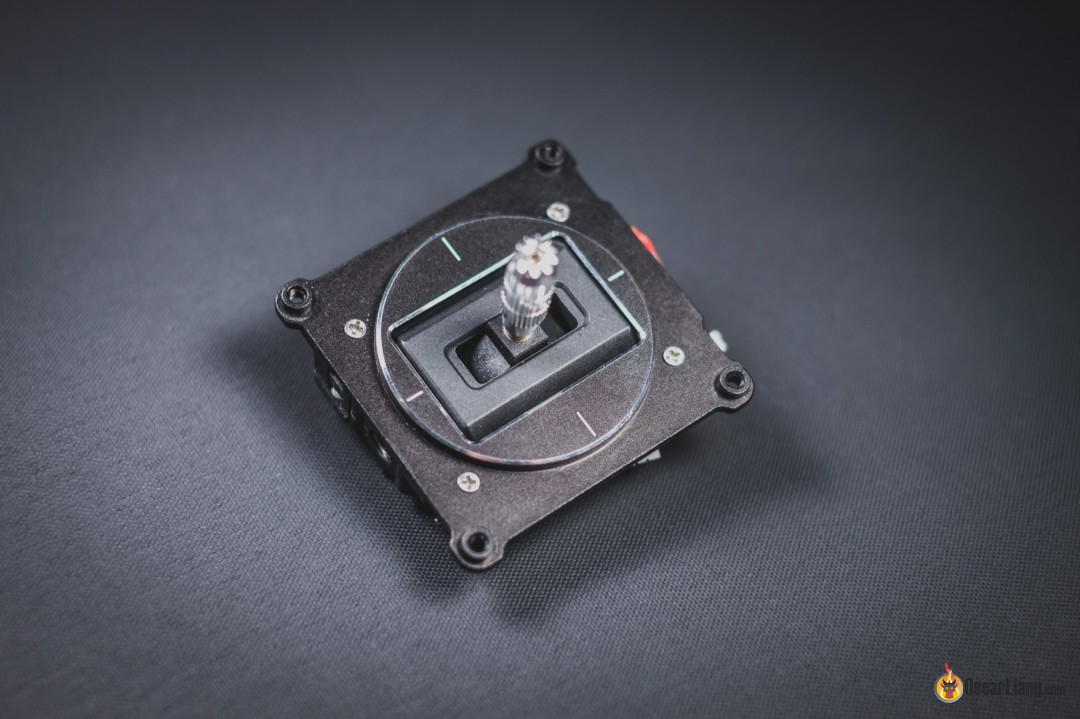

From memory similar application that i know of that uses hall sensors if a gimbal for a RC radio the Frsky M9 Hall Sensor has 1024 resolution. These can be purchased for ~$27 per gimbal and have 2 hall sensor and 4 ball bearings in a + configuration "joystick" if you will.

For reference the Frsky taranis m9 gimbal uses a A139x-rev0.1 hall (thats printed on the PCB).
