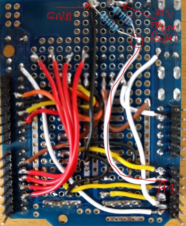

Hello guys, i'm still newb i have a problem that i cant understand
I have battery of 12 volts, connected over "LM 2596 Step Down Adjustable Power Supply Module" to arduino and relay.
I connect 12 v from battery (Before stepdown module) to voltage divider (via resistors) to A1 pin (see the attached scheme)
When i measure current on A1 with with multimeter - i get ~ 4.0 - 4.5 volt depending on battery charge/.
When i print results to serial terminal via usb using function analogread (A1) i get something simmilar (+/- 0.3 volt)
BUT, when i disconnect USB, and connect LCD for example, i always get 5 volt (or 1023) reading!
Help me, i have no ideas what to try next!

Attached general scheme drawn by hand.
I've also tried to connect gnd from R2 to arduino gnd (as shown in dotted line in scheme 2). Same effect, measures current only on USB connection.

Why are you putting 5V into the DC jack, that needs 7volts or more to get 5V from the Arduino's onboard regulator.
I think you need to connect the 5V supply to the 5V pin on the Arduino board and the supply gnd to the Arduino gnd.

turns out RichardDL was right! i connected my 12v bat directly to arduino, works like a charm!
Althou SIM 900 gsm shield does not have enough current to make a call, voltage measurements are correct!
If anyone has tips how to provide SIM 900 with enough current from arduino (without using external power source) - tips highly appreciated
You can't. The onboard reverse polarity protection diode is only rated for 1A, the 5V regulator for 800mA (and you won't get that with 12V at the barrel jack, the part will overheat and into thermal shutdown first), the 3.3V regulator just 150mA. You need an external supply.
