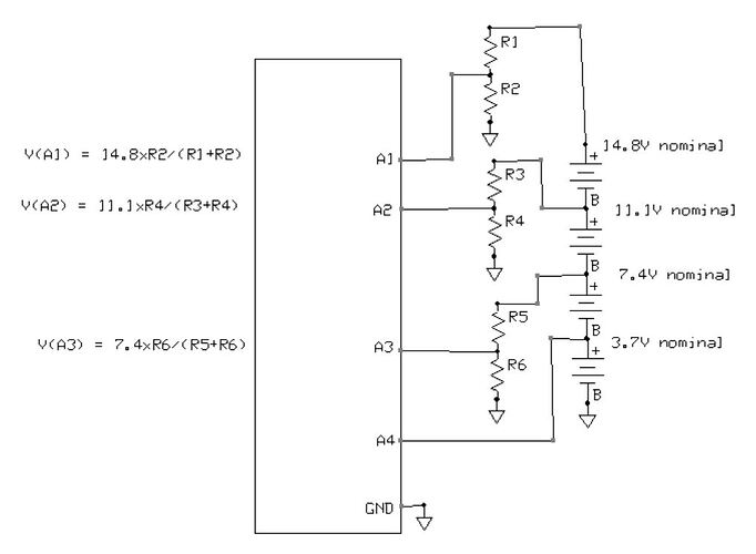

Hello, I intend to make a very primitive bms with which I can monitor the voltage of four 18650 batteries connected in series. The problem was that a short circuit was caused when connecting the batteries to the analog pins. The code I used was the following.

the circuit diagram is attached below, thanks.
Seems to me that apart from the lowest cell in the pic, you're putting over 5V into the analog pins. The top one's getting almost 15V.
What's going into each pin is the sum of the cells from the ground up (to coin a phrase), not the voltage of the last cell only.
It's not a short circuit. It's an over voltage.

If the batteries are charged:
A3 has 8.6 volts on it (3.6V over the maximum)
A2 has 12.9V on it (7.9V over the maximum)
A1 has 17.2V on it (12.2V over the maximum)
You don't have a short, but depending on those resistor values you may have fried the Arduino! ...10K resistors should safely limit the current and then there are small (low current) :"protection diodes" in the ATmega chip to prevent over-voltage.
**What you need is **Voltage Dividers
So, A4 sees 3.7V
A3 sees 7.4V
A2 sees 11.1V
A1 sees 14.8V
And higher if the batteries are charged to 4.2V.
One way you can do this is to use voltage dividers to keep the voltage <=5V.
Your mission: find R1 thru R6 such that V(A1), V(A2), V(A3) do not exceed 5V.
You also want low current draw so the resistors don't excessively drain the batteries.
I'd start with a common value for R2,R4,R6 and calculate for R1, R3, R5. Say 5K.
For example if R5 is 3.9K and R6 is 5K, that V(A3) = 7.4V * 5000/(3900 + 5000) = 4.41V
and if the batteries are fully charged, then V(A3) = 8.4 * 5000/(3900 + 5000) = 5.006, which is higher the 5V reference used by the ADC in an arduino, so the readings will max out at 1023. So, select a different R5 and recalculate,
