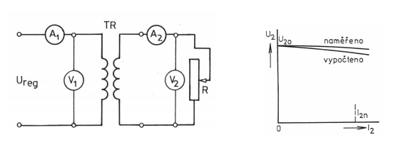

Okay, sorry i realise that i've given you kinda shitty explanation. Well, my task is to measure voltage like U2 on picture i have shown here. The problem was that i know that messing with wall voltage and transformers can be pretty dangerous, so i was asking if anybody knows there is a safe and easy way to do this.
in my opinion the picture given isn't something you would plug into your arduino, since transformers can reduce voltage to safe level for arduino (if you pick the right one), but they don't handle negative values and arduino cannot handle these negative values as well. Is my idea about this right? Is there some way around this problem?
Well done posting that drawing! What is the range of V2/U2 You intend to use?
That's true, don't apply any negative voltage to the controller. (-0,5 something is the minit).
If i understood your question right, the range would be basically anything that's safe for arduino, which is 5V - then you could calculate the values from 0-5V to 0-230V, i understand that this isn't the most accurate way to approach this, but it's a school project.

Transforming to voltages like 5 to 12 volt is a good way to be safe.
Diodes can be used to only send the positive part of the AC curve to the controller. The disadvantage is that some voltage is lost across the diode. OP amp circuitry could compensate for that, only I have no diagram to send You.

So, if i understood correctly, using even 12V as maximum voltage for analog input is still safe?
Yeah i thought a bit about diodes, though you are right that opamp is better way to do this. Anyways, thanks alot for your help

12 volt level is safe for You but not for the controller. A 12 volt signal can be lowered to the 5 volt range using a voltage divider. Don't forget that 12 volt AC is the RMS value. The top value is 1.412 times 12 volt...

Alright, so transformer with 12V as secondary value would work fine, if i make voltage divider there? Is there any other parameter of transformer that i should watch out for?

You might need to calibrate the transformer, compare low voltage out relative to mains in. As You will draw very little current from the low side some transformer variations will not disturb.
