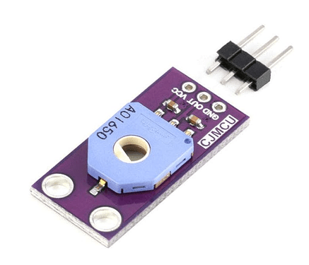

see this, it is only $11.99 for 5 pcs
https://www.amazon.com/ACEIRMC-CJMCU-103-SV01A103AEA01R00-Trimmer-Potentiometer/dp/B094XT5WMS/ref=sr_1_1?crid=2EPQ6I9ESQ00M&keywords=CJMCU-103&qid=1689751062&refresh=1&sprefix=cjmcu-103%2Caps%2C382&sr=8-1

Potentiometers will do the job quite well. The main issue is mounting them so they don't break. They have to be mounted in a way so they're not carrying any of the force from the pedal.
Ideally you'd couple them to the pivot of your pedal through a belt (I like heavy duty rubber bands for cheap belts) or a length of tubing. You can buy shaft couplers that handle a few degrees of misalignment, but they may not fit in the whole "under $20" thing.
