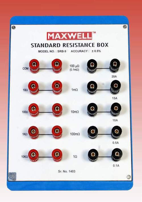

Hello Allan sir, I have read some - but there is a huge difference when designing the real thing. I want to get atleast some accuracy in my measurements.
Your recommended circuit looks very good - but I don't have the opamp right now. Need to be imported if I want to use it, so I am making a BOM for all such components regarding different circuits.
I will test it in real field, but for now I checked my ads1115 and the mcp3551s with the divider in a resistance box similar to this image.
https://pimg.tradeindia.com/02230255/b/1/Standard-Resistance-Box.jpg
Once my resistance tests are accurate then I will test on other materials and then actual soil on field. (Check wenner 4 point config.)
