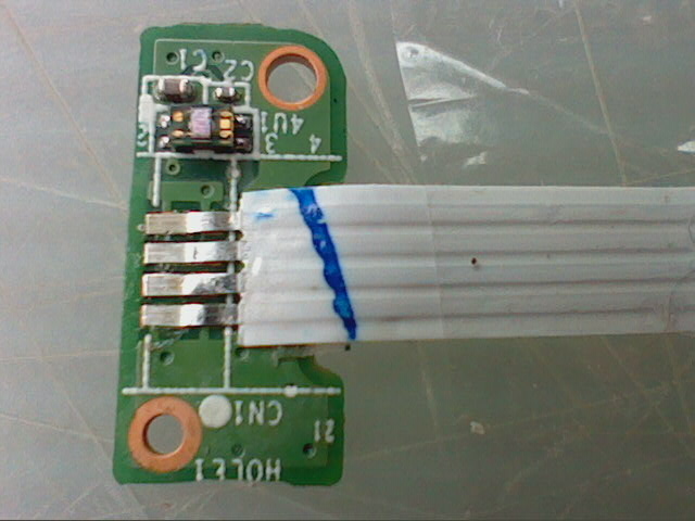

recently I bought some cheap LiPo batteries sold at a german online shop for sale of remnants. I did some research and found that the battery packs are normally used in the Kindl Fire. With the battery pack I got also a light sensor used in the Kindle to adjust the display to ambient light. (-> http://www.ifixit.com/Guide/Installing+Kindle+Fire+LCD/7929/2).
Investigation on the internet I found that the sensor CM3217 from CAPELLA Microsystems is used. The communication with the sensor is I2C based. With the I2C scanner i found two adresses for the sensor. Based on this site rk3066-kernel/cm3217.c at master · AndrewDB/rk3066-kernel · GitHub I was able to read out the sensor but I did not understand all the protocol options.
Unfortunately the company does not offer a datasheet, so I wrote a mail to them. I got an answer with questions about "my project". I described my interests but it seems that the Arduino community is not interresting for Capella Microsystems.
I think the sensor is very useful and easy to use with the Arduino because it can also be found as a cheap repair part in the internet Kindle Fire Parts for Repair.
Is there somebody in the community who has a datasheet with the full I2C protocol of the sensor ?
Or can somebody re-engineer the protocol from the above driver?
Here my code to read the sensor:

hey, i know this post been created long time ago, i just found it incidentally..
cut to the chase;
part of my Univ. project is measuring the Lux (then calculating haze, according to test results) , so need high sensitive ambient light sensor for it, like Capella's
but sadly they answered me with this :
"(..) our business model is only to support high volume OEMs and to release the details and specs of our part to customers under NDA. So unfortunately we cannot support your request. (..)"
so i think that means u need to use those sensors in mass production or sth like that..
which is not me..
and sadly their sensors seem to be best on being really sensitive...
so, any idea?
