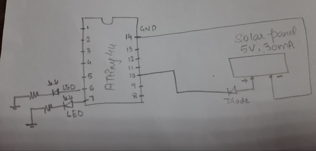

You're not charging the battery through the analogue pin, or are you.
The solar panel should connect to a charging circuit, to safely charge the battery.
The solar panel could also connect through a resistor or voltage divider to an analogue pin, to detect day/night.
Please provide a full circuit diagram.
Leo..
Now, the positive side of solar is going directly to IC physical pin 10 whereas, the negative goes to ground.
In order to avoid any reverse current i have connected one diode at positive side of solar panel. It is a very simple prototype. Handling the battery voltage code is already there.
Your basic circuit shows no solar backflow protection diode and no connection to the battery.
So the battery must get it's charge through the pin protection diodes of the Atmega chip.
This is BAD.
Day/night detection should be on the panel side of the backflow diode, while the battery and charging circuit should be on the other side of that diode.
How do you control battery charging. You can't just connect a 4volt panel to a LiPo battery.

This my solar panel the blue wire goes directly to ic and the black one goes to common ground.
Hi, @anon45846334
Can you please draw a readable and accurate schematic with ALL your components.
Use proper pinout names and layout.
PS. if your CAD package does not have your component, then please hand draw your circuit for clarity.

i forgot to connect vcc and gnd to main battery in the drawing.
Hi, @anon45846334
Where on your schematic are the other pins used and what are they connected to?
I see no connections to pins 1-5 8,9,11,12,13
I see no connection to Vcc pin 1
I see no battery
to charge the battery there will need to be a connection
capable of passing charging current
between solar panel ground and battery -ve ... and ..
between solar panel + and battery +
with some electronics that manages the battrey charging current
I think even explaining this project is beyond your current level of ability.
Oh you need to see the entire schematic, i thought it was just solar connected you wanted to
My issue is not here the circuit is working perfectly, the problem is with solar .
