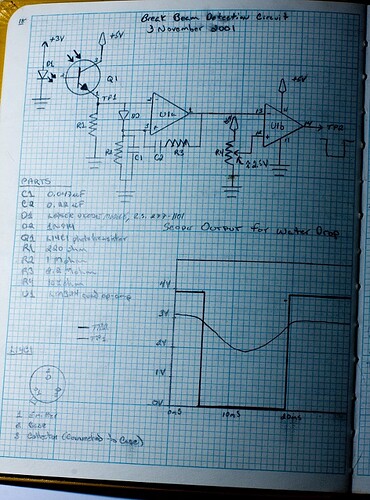

I am trying to measure the speed of a 6mm spherical projectile moving slower than 700 FPS. I was going to use photo resistors but discovered they are too slow.
is there any other options?

I was just thinking of using IR led and IR detector. Does anyone know the response time for one of those?

Id say use a phototransistor and a led(or laser even better) and have that trigger both ends, a little more resuable and should be fast enough
im sure the commercially available CHRONY uses IR sensors, I would imagine that is the way to go,
I am interested to see how this works out for you, i wouldnt mind making one
An LED and a phototransistor works fine for this purpose (depending upon the distance between transmitter and sensor), but the issue is a little more complicated by the need to work in ambient light which changes. You want a detector that will only notice fast changes. Attached is a scan from my lab notebook of just such a circuit I used to detect projectiles many years ago. This should work as a good starting point for you. I believe all of the components are both readily available and fairly cheap.
For the following I used a laser, mostly because it was available and the distance between the transmitter/sensor I was using was several feet, the same circuit also works with a matching led for smaller distances.
