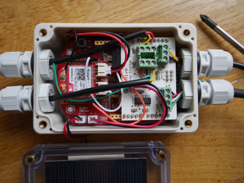

You can see on the first photo the complete bee monitoring system:
  • The main electronics in the middle.
  • Right in blue, a drilled cup with a DHT33 / combined humidity/temperature sensor for outdoors.
  • Below are the load cell for a unilateral weight with aluminum L-profiles.
  • On top 5 DS18B20 temperature sensors (can be more also) for the brood nest area.
  • Left side in curlers (against cementing) a DHT33 for indoor use.
All sensors are connected with round cables, which can be good passed through the screwable, waterproof cable glands on the case. An exception is the temperature array for inside (on top of the photo). There is a small board as flat cable connector. With this flat cable it is very easy to connect a pin header as as branch for the various temperature sensors between the combs.
The electronic case with a small solar cell under the transparent acrylic cover. The box is waterproof. The screws started after a wet day to rust. The box in the photo is on the balcony for about a month.
Inside the box it's quite busy:
  • At the bottom you can see the Seeeduino Stalker (red board), an Arduino derivative with additional clock (RTC), a charging circuit for solar panel and Lipo and a bee socket. "Bee socket" has nothing to do with bees ... haha! On the bee socket, the GSM / GPRS module sits, with "SIM800" print.
  • Right (white) is the self-designed shield with the load cells IC, some screw terminals, resistors, caps. Currently we have connections for a load cell and up to 3 DHTxx or DS18B20 sensors.
  • The small printed antenna for the modem is between board and housing, a black cable goes (almost invisible in the pic) from the modem to the antenna
  • The rechargeable battery, a Lipo, is under the Stalker and and so not visible.
