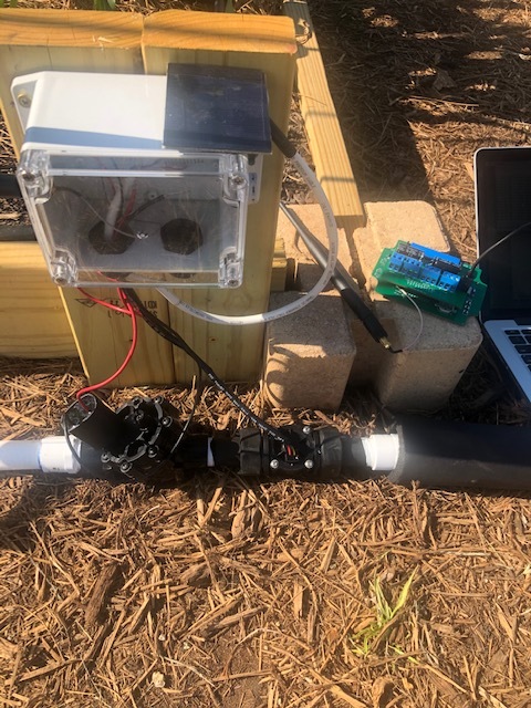

Great news! I just tried the plastic flow sensor and I'm getting flow! It's about 6 pulses per second which is about right. The design of the plastic flow sensor is more of a paddle wheel rather than the propeller design of the brass flow sensor.
I attached a picture for reference. What you're looking at is a small piece of a larger project I've been working on for almost 2 years in spare time. I started off knowing nothing about hardware/Arduino, and now I've designed a custom Arduino LoRaWAN board that can have replaceable daughter boards. It's basically a more refined Arduino board (solar connection, LiFePO4 battery, LoRa, 5V regulator with EN, RTC for deep sleep) which breaks out 20 pins for daughter boards. I've also developed a backend + mobile app to control/configure it all.
Kinda crazy really... I pretty much learned how to do everything on this forum (even SMT hot plate soldering). Anyways...
Can you explain what kind of set-up you are using? What hardware? And what code are you using you read the sensor?
It's an nRF52840 connected to the above hardware. I'm using a hardware timer to count pulses while the valve is open.
