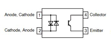

  • Google opto coupler.

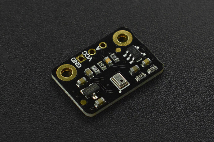

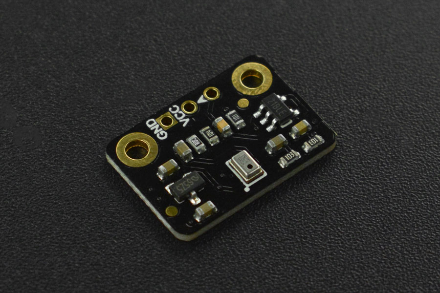

A Nano 33 BLE Sense and Sense Rev2 have an on-board microphone and BLE.

jim-p, should I assume you're suggesting I just wire this microphone module to my Arduino, then place it directly on/next to the chime speaker, and analyze the readings I get in my Arduino code? Sounds like a simple solution if that's the case.
Put in the chime box or outside, whichever you like. You just need to do an analogRead and it goes over some threshold do what you want.
