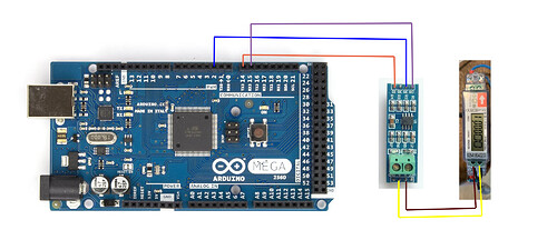

mega 2560 - max485 - inepro pro1-mod modbus does connect but doesn't send data
Dear everybody,
after 2 weekends of being busy with this modbus stuff, my wife is getting fed up with me. Because I haven't got a place to store my Arduino stuff and work on it at the same time, the living is becoming a mess. So please help my wife (and me). :sunglasses:
I have tried lots of different libraries and code but I ended up with the code writtten down below. This code gives an error in the output monitor that says:
Exception errors: 0
Failed requests: 9
Successful requests: 0
Low byte: 0
High byte: 516
Voltage 0.00
Exception errors: 0
Failed requests: 11
Low byte: 0
High byte: 516
Voltage 0.00
The Energy meter, you might not be able to see on the picture, gives the communication blink (com) but sadly doesn't give the output I was hoping for on the PC.
the manual of the inepro pro1-mod is downloadable here manual
On page 25 is the register.

for now I'm trying to read the voltage (register 5000).
If somebody knows, Thanks al lot in advance!!!
I cannot find an obvious error in your code, except that you're requesting two registers but provide space for only one (this doesn't pose a problem yet because the connection fails anyway).
But I recommend not to use SimpleModbusMaster but ModbusMaster instead as it provides return codes that tells you what kind of error occured and is usually easier to use in the end.
Once you've done that, post the return code you got (error code) as well as your changed code!
Check the Modbus ID, baud rate and parity on the meter as well as the polarity of the RS485 connection.

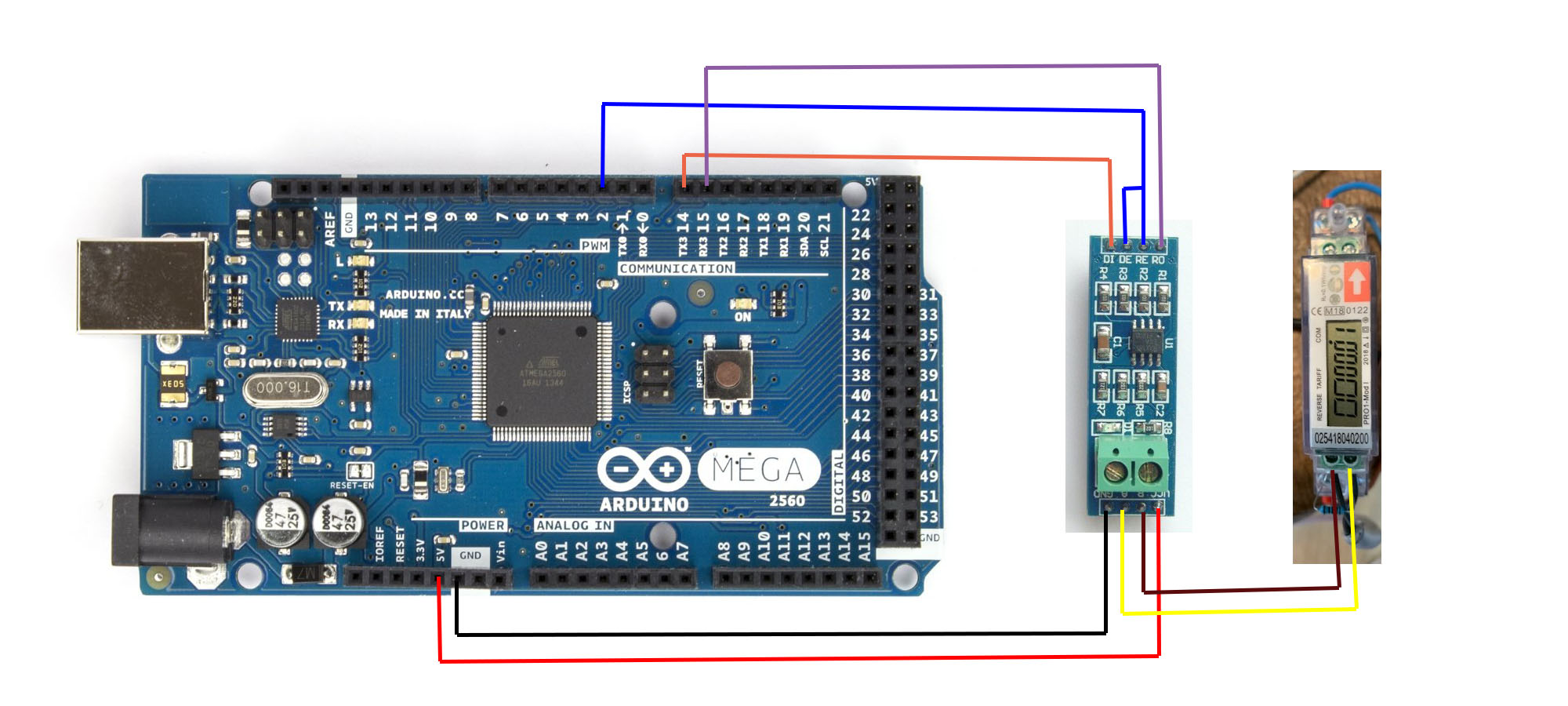

Thank you Pylon,
I've been busy selfteaching me this part of arduino... and finally (with the help of this forum) I got it working :slight_smile:
First, I have changed the parity in the meter from "even" to "none" (which is the default in ModbusMaster)
the code that I've used is as following

the wiring is as follows:
No, it's just configured that way in your code.
Change the line
Serial3.begin(9600);
to
Serial3.begin(9600, SERIAL_8E1);
and you can activate the parity bit again (which is not a bad choice).
