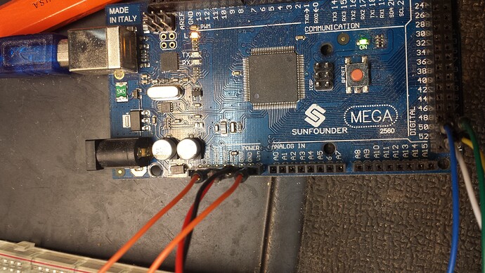

Well I will admit I am a bit new to the Arduino but I have used the ArduinoMega2560 in the past to program the Attiny85 without issue.
I am attempting to use the Atmega2560 as an ISP for a Atmega328P-PU with its internal clock.
The issue I am having is after burning the bootloader which returns no errors. As soon as I upload any sketch I get:

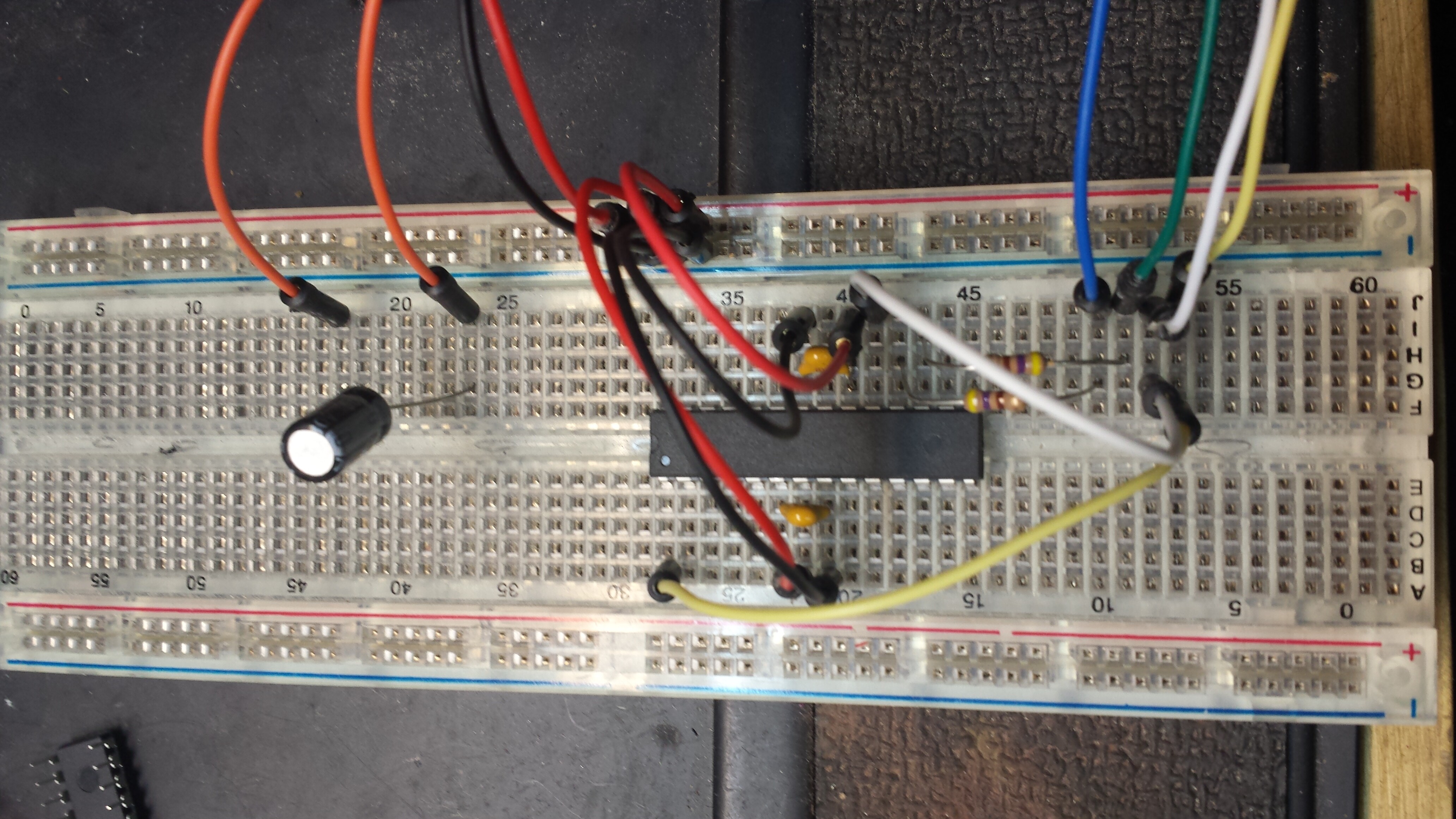

This is using the AtMega on bread board boards file and without an external clock.
The pin layout is:
AtMeaga2560 AtMega328
50 18(MISO)
51 17(MOSI)
52 19(SCK)
53 1(RESET)
  • 7(VCC)
  • 8(GND)
I did try adding power to pins 20(AVCC) & 22(AGND) per a different thread and believe that fried the chip. (luckily I have a few)
I have used both a 120ohm resistor and .10uf capacitor in attempt to disable the reset when uploading the sketch. I do not need to do either to burn the bootloader successfully. I also was able to program the Atting85 without disabling the reset on the mega2560.
The Mega 2560 is plugged into a Plugable USB Hub with a separate power supply but I have also tried powering the Mega328 separately.
The ArduinoISP sketch I am using is version 04m3.
The computer is a Windows 7 Home Professional.
I have not yet tried using the 16mghz crystal as an external clock.
I am open to any ideas. I have tried finding something online for a week or so to no avail.
I appreciate any assistance.

dodgeluver85:
I put it from reset (+ capacitor) to ground(-of capacitor) (per http://arduino.cc/en/Tutorial/ArduinoISP) after uploading the ArduinoISP. ... Then I hooked the capacitor up before clicking upload and I get the same error. Perhaps I am misreading the tutorial is that the correct way to wire it up?
After uploading ArduinoISP to your Mega connect the capacitor as you described and leave it.
I suggest adding series resistors to the three programming lines (MISO, MOSI, SPI) to protect the two processors. Anything between 220 ohms and 1K ohms will work well. A wiring mistake (especially with MISO and MOSI) creates a short-circuit through both processors.
dodgeluver85:
The pin layout is:
50 18(MISO)
51 17(MOSI)
52 19(SCK)
53 1(RESET)
  • 7(VCC)
  • 8(GND)
Pull-up on reset? Bypass capacitor on VCC and GND? Bypass capacitor on AVCC and AGND?
You really should fully power the target (the ATmega328P). There is no way adding power to AVCC and AGND fried the target.

So to make sure I am understanding you correctly I need to apply 5v to AVCC & VCC as well as ground AGND a GND. Do I need to add additional capacitors to the target?
dodgeluver85:
Yes.
You need a 0.1 uF capacitor across VCC and GND as close to the processor as possible. You need a 0.1 uF capacitor across AVCC and AGND as close to the processor as possible.
Well I added the resistors in line with the MOSI & MISO but I do not have anything connected to the SPI(SS) so did you mean the SCK? I also added the .1uf capacitor between AVCC & AGND and VCC & GND. I will attached 1 picture of the wiring and will post a second after this. To let you double check my steps:
Select Arduino2560 board in software

Here is the second picture. I appreciate all of your help on this and hopefully you'll see what I am missing.
Thanks
just an update..... I tried adding the 16 mhz crystal across pins 9 & 10 with a 22pf capacitor from GND to 9 and a second from GND to 10. The crystal was after the capacitors (closest to the chip. I chose the Arduino Duemilanove w/ Atmega328 as the board and ArduinoISP as programmer (this was after the mega2560 was uploaded with ArduinoISP) It returned the same results. The bootloader was successful and the sketch upload return avrdude: stk500_getsync(): not in sync: resp=0x00.
         Overriding Baud Rate          : 57600
Oops. Wrong baud rate. It should be 19200.
I just noticed that... I saw the bootlaoder at 19200 and I started looking. do I need to change that in the preferences.txt file then or is there an easier way?
