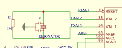

Mega2560 resonator
Please see from the attachment Mega2560 schematic.

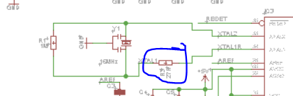

From other version (for example Eagle) exist 27oHm resistor from the same circuit.
Also 2 version of board:
  • with 22pF capacitors
  • without capacitors
Questions:
Is this 27oHm resistor needed?
Are these 22pF capacitors needed?
A quartz crystal needs loading capacitors, a ceramic resonator doesn't, but has a ground pin as well.
What 27 ohm resistor?
Thank you for explanation
please see attached schematic from eagle for resistor
