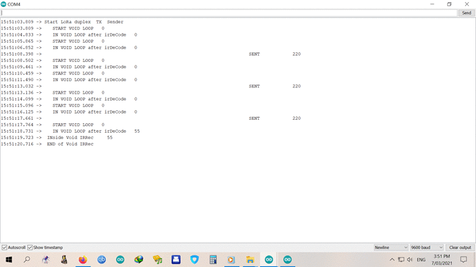

I am trying to merge "include <LoRa.h>" and "include <IRremote.h>" so that I can use a remote control
to send specific information via Lora.
Seperately, both Sketches function exactly as expected , however when I merge them together the
merged sketch works fine until it receives the signal from the remote then it displays the data once
and stalls.

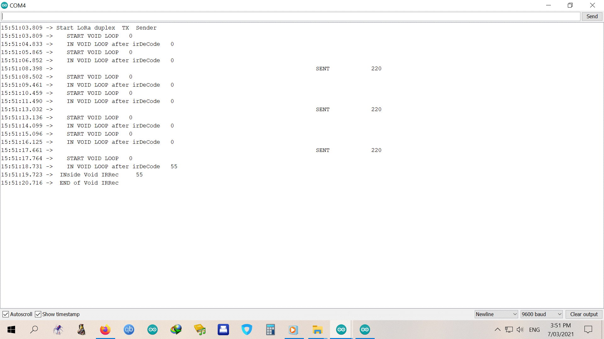

This is the Screen Print of the outputs.
