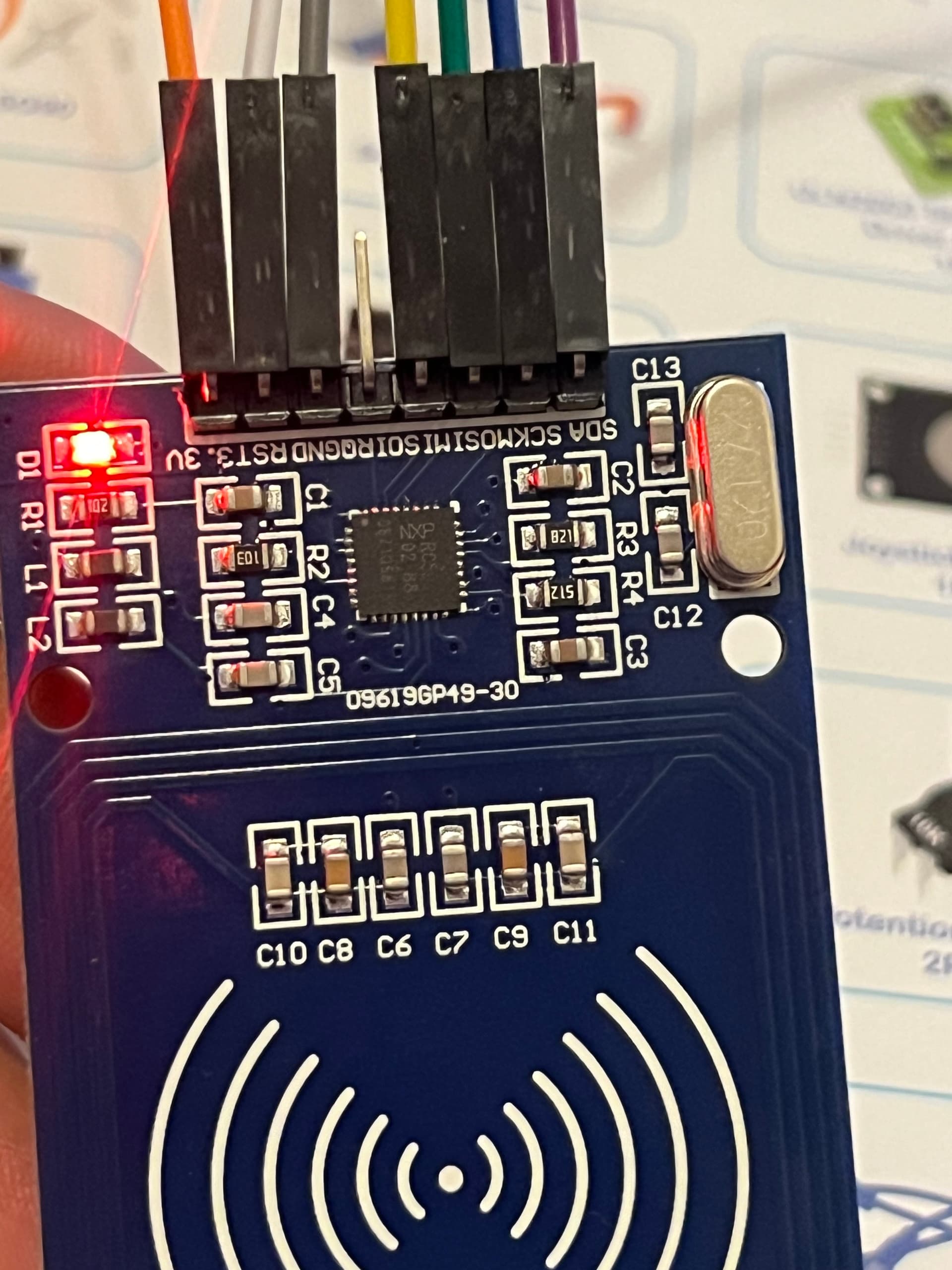

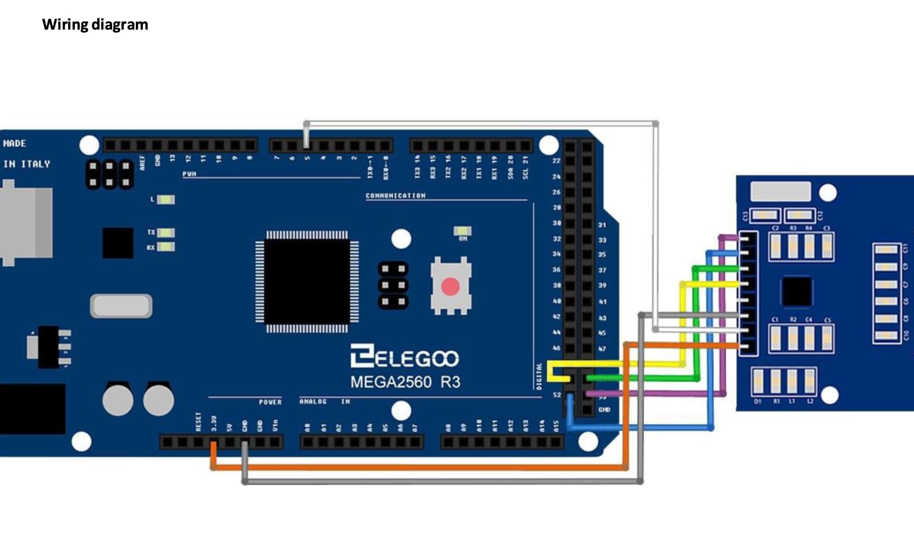

This is the wiring diagram provided by the instructions:

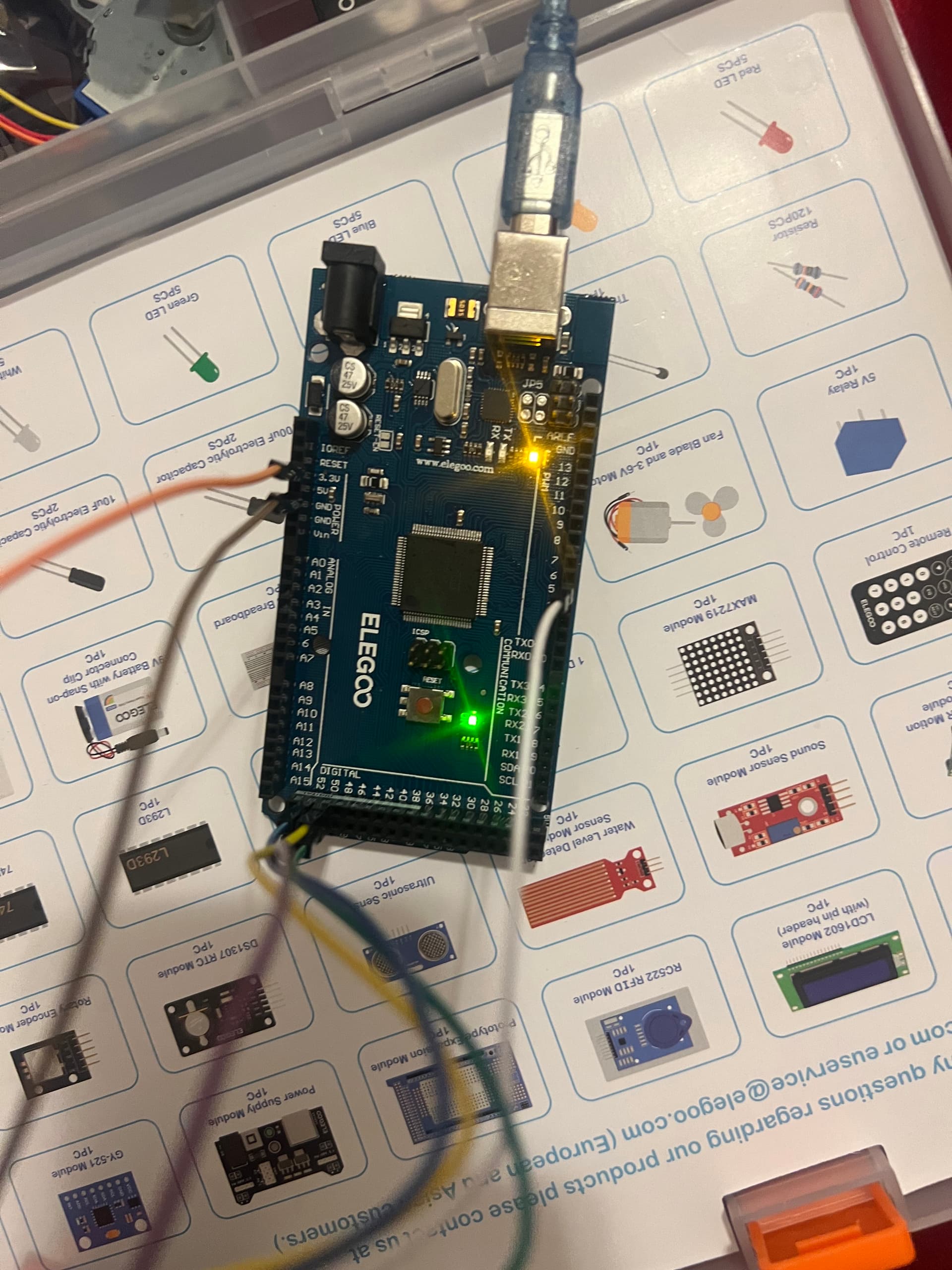

This is my wiring setup:
This is what is outputted on the serial monitor:

Try with a sketch that only prints the information of the card you present.
this sounds bad... (might still work but does not seem future ready)
using Mega pins
  *SPI SS      SDA(SS)      53
 * SPI MOSI    MOSI         51
 * SPI MISO    MISO         50
 * SPI SCK      SCK         52

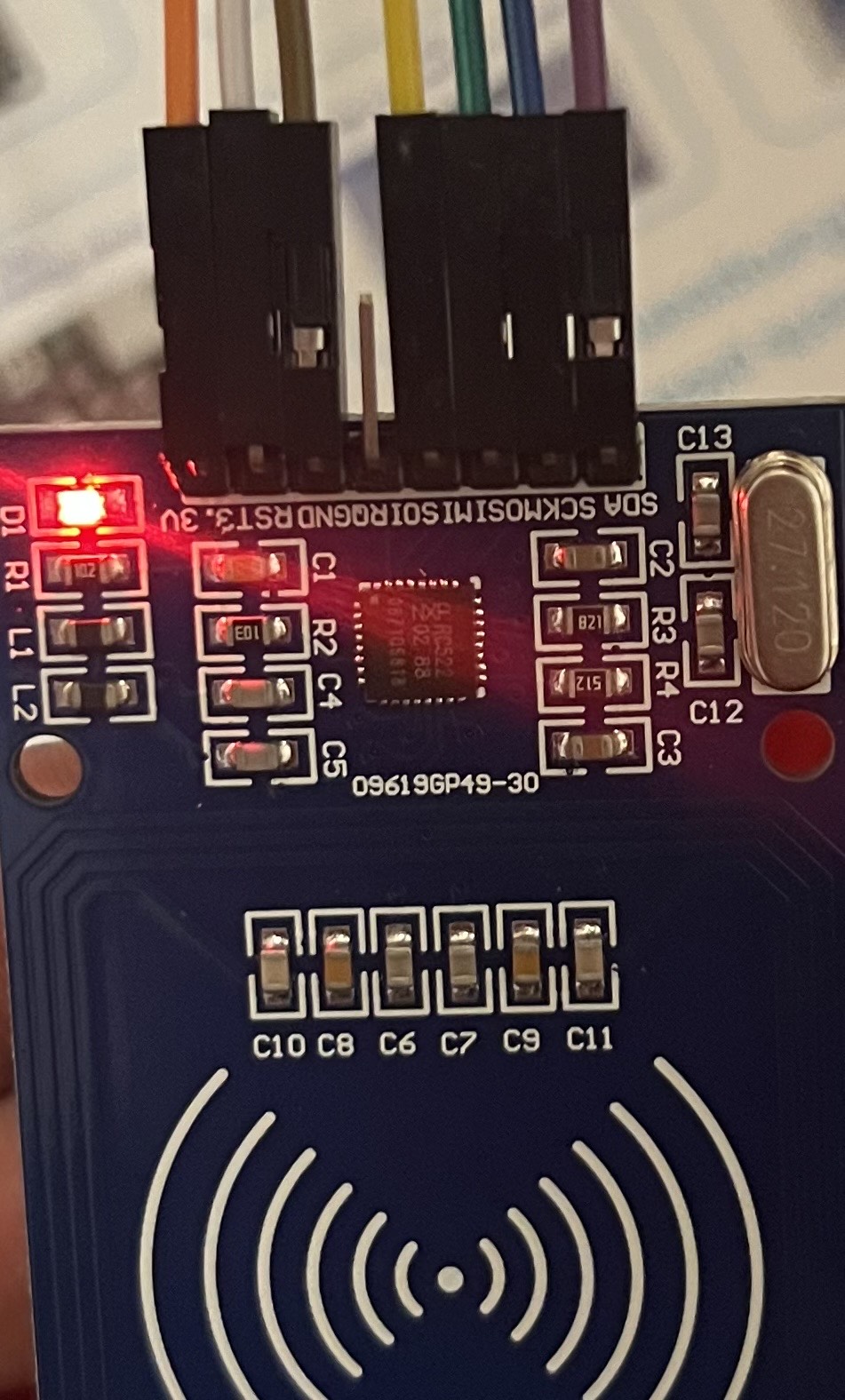

My wiring for reference:
My code:

if I run post 4 code I get
MFRC522 Digital self test
Firmware Version: 0x92 = v2.0
Only known versions supported
Performing test...
Result: OK
if I try a different MFRC522 I get
Firmware Version: 0xB2 = (unknown)
Performing test...
Result: DEFECT or UNKNOWN
clearly program only works for certain MFRC522 modules
however, if I run File>Examples>MRFC522>ReadNUID on the same MFRC522 it works

Sadly this is incorrect, but most of the internet thinks this is how you do it.
The problem is that the Arduino Mega2560 is a 5V device and so gives 5V signals out. While the RFID reader is a 3V3 device and so a 5V signal is too much for it, and will damage it. Therefore you need to cut down any signal dent from the Mega to the reader needs to be cut down to 3V3 to avoid damage. This can be simply done by using a potential divider on each pin. This means the correct wiring should be:-
Indeed.
This library's doc does explain it
Arduino UNO/Nano/Mega operates at 5V logic. However, the MFRC522 works at 3.3V logic level, and is not 5V tolerant. If using one of these microprocessors:
  • You must use a 5V <-> 3.3V level shifter on any lines that send HIGH output from the Arduino to the MFRC522. These are RST, NSS, MOSI, and SCK marked with an asterisk in the list above.
  • You may use a 3.3V <-> 5V level shifter on those lines that send HIGH output from the MFRC522 to the Arduino (MISO) though this is not generally necessary - a HIGH 3.3V signal will normally be recognised as a HIGH signal on a 5V system too.
  • But, while logic level shifters solve the problem of interfacing between devices at different voltages, they can introduce other problems... simple bi-directional convertors use transistors that can be slow to react, and this delay damages the timing and quality of the signal. This can be mitigated somewhat by explicitly slowing down the speed of the SPI interface in the Arduino code, by including #define MFRC522_SPICLOCK (400000u) (Sets SPI bus to 400kHz) prior to including the RFID library.
  • MOSI, MISO, and SCK lines are shared between all readers, and use Arduino SPI pins 11(MOSI), 12(MISO), and 13(SCK).
  • NSS lines must be assigned to unique GPIO pins for each reader.
MFRC522 to Arduino using SPI
That's very odd I would imagine that the instructions that come in the kit would be right. It doesn't have a level shifter either so, because it should come with necessary things that I need to do that. I was watching other youtube videos and I did the same thing as them theres worked and mine didn't.
You are not the first to discover that ELEGOO supplied RFID readers do not actually work. We have had a few reports of this in the forum.
It is amazing how many suppliers of information, especially on You Tube, and the Instructables web site do not know what they are doing. What happens is someone does something and every one just copies that.
If you want to see this in action then search for how fix sticking keys on a TV remote. They all have a line which says something like "remove the batteries and hold down the on key for thirty seconds to allow any residual charge to discharge". This is utter nonsense and it might as well say "throw some salt over your shoulder and turn withershins three times".
This is because :-
  1. If there is a sticking key causing problems that will discharge any current in the system once the battery is removed.
  2. The bit that does the freeing of the keys is an entirely mechanical action so it makes no sense if the remote is powered or not.
Yet all the instructions and videos tell you to do this. So in the world of then internet it becomes a "thing".
This is exactly the same with the myth that you don't need level shifting when interfacing a 5V processor with a 3V3 system. Or the other myth that you don't need some form of current control when connecting an LED to any processor.
But you don't know how long they worked for. Doing this will shorten the life of components and they will fail sooner than they should. How long they will last you can only tell by testing at least 100 such circuits at an elevated temperature for about six months and counting the number that have failed. That is what profession system suppliers do to get the MTF (Mean Time between Failure) of any system. I know, I used to design set top boxes for satellite, terrestrial and cable TVs.
Look at how many threads we get here about stuff suddenly stopping working. We try and ask the people asking this to post a schematic so we can check they are not doing something stupid like ignoring the limits of components but often they say what is the point it used to work?
Conclusion:-
Buy another RFID reader from Ebay, much cheaper than Amazon (most stuff is) and aviod stuff from ELEGOO.
agreed!
on a device which uses 3.3V logic unless pins are specified as 5volt tolerant the device can be damaged if 5V logic is applied
in practice 3.3V devices may work with 5V logic for an minute, an hour, a day, for ever or fail immediately - you don't know - use level converters or even better switch to a microcontroller which uses 3.3V logic
this applies to WiFi modules, displays, sensors, etc
