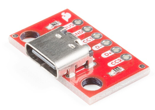

Thank you. I found this Raspberry Pi 4 Licensed White Power Adapter - 5V-3A Oriinal buy at affordable price - Direnc.net® .This will work then right ? 5V 3A. I will cut this cable and Red one will go Vcc, black one will go GND.
Probably that's fine.
BTW, If you got such a breakout board, you don't have to cut the cable. :wink:
Thank you so much. I will try to have that .
