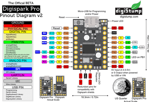

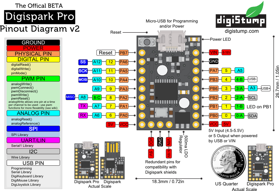

How about ATtiny?
It has a board called Digispark, acts as a HID joystick using the software USB stack (V-USB).
The cheaper than mega, and the clone board is also cheap and small but therefore only a few GPIOs...
[http://digistump.com/wiki/digispark](http://digistump.com/wiki/digispark)
> **[GitHub - digistump/DigistumpArduino: Files to add Digistump support...](https://github.com/digistump/DigistumpArduino)**
> Files to add Digistump support (Digispark, Pro, DigiX) to Arduino 1.6.X (1.6.5+) - GitHub - digistump/DigistumpArduino: Files to add Digistump support (Digispark, Pro, DigiX) to Arduino 1.6.X (1.6.5+)
Please use DigisparkJoystick Library included as standard.
Digispark has install a micronucleus boot loader, you can write from the ArduinoIDE using USB.
Namely, without a high voltage programmer even if you change the RESET pin to GPIO.
but it may still not be enough for the number of GPIO you requested...
It may be possible if you review the project design and omit few GPIO.
