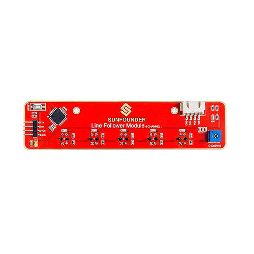

Are you looking for a line follower module or making your own circuit(s)?

I am trying to make my own.
