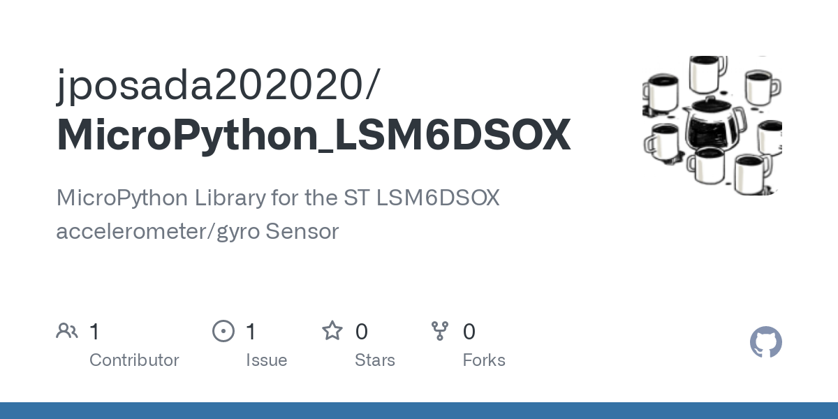

This is the library I'm looking at. In the Simple Test example, this is the code to start it:
i2c = I2C(1, sda=Pin(2), scl=Pin(3)) # Correct I2C pins for RP2040
lsm = LSM6DSOX(i2c)
This is my question, since the IMU is built in on the RP2040 connect and not hooked up by pins, what would I put for those values? Would this library work with the RP2040 Connect?

This is the code, its from the examples file from the library listed above
import time
from machine import Pin, I2C
from micropython_lsm6dsox import LSM6DSOX
i2c = I2C(1, sda=Pin(12), scl=Pin(13)) # Correct I2C pins for RP2040
lsm = LSM6DSOX(i2c)
while True:
accx, accy, accz = lsm.acceleration
print(f"x:{accx:.2f}m/s2, y:{accy:.2f}m/s2, z{accz:.2f}m/s2")
gyrox, gyroy, gyroz = lsm.gyro
print(f"x:{gyrox:.2f}°/s, y:{gyroy:.2f}°/s, z{gyroz:.2f}°/s")
print("")
time.sleep(0.5)
