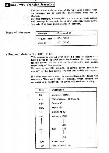

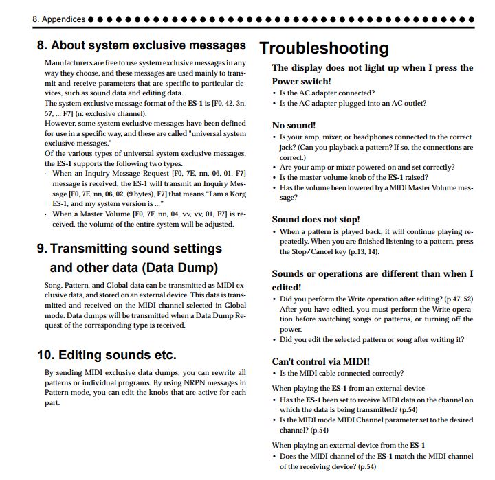

Many years ago i made a Patch/Timbre/Tone/Envelop editor for Roland D-10 on a Commodore 64 and after on Amiga.
And sysex data transmitted is differents from a productor/model and another, not are a standard on number of bytes trasmitted.
I see for example that Korg ES1 can have also 9 bytes messages.
Or my Roland D-10 want a check sum of data trasmitted at end of message(first of F7 that is end of exclusive).
So good luck with Sysex mesages, i post 2 screen of manual ( Korg and Roland) about sysex.
Bye
Thanks !
Encoding sysex on the ES1 is done with only 8 bytes, as explained in the midi implementation txt doc. So it is close to what we could suppose to be the encoding standard (as discussed with the author of midi library).
I didn't realize at first, the bits encoding was the reverse of the one coded in the Encode/decode Sysex funcs, because in my ES1 dumps I had a lot of 7 bits data....
But you are perfectly right, SYSEX is so specific... and often badly documented.
For ex , on the ES1 no need to send a checksum. On Roland it is mandatory.
but at less the 8 bits bytes encoding often follow the same logic....
