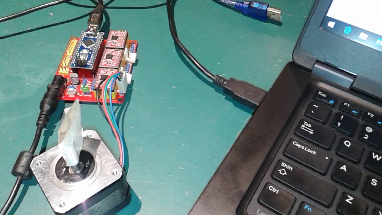

I have tried to plug the new arduino + shield , replacing the shield v3
initialization seems ok, grbl 1.1 (with universal gcode sender)
but motors dont move ... :confused:
if you have an idea..
thank you
Ludo

Hello,
Thank you for answers,
I've make some tests, I'm using Universalgcode sender for just moving X+ or X-
The motor is vibrating but not moving correctly
I saw that the possible problem was the voltage : cnc V4 accept only 12V but my old V3 was 24V
I dont want to do some extra wire on the board the board
so i will do other tests to reduce speed
I looked at the video. At the time 02:00 and on that guy is explaining how to use more than 12 volt.
The plug he points at I want to call "the barrel plug". It surely goes to a tiny 5 volt regulator feeding the controller, and optionally the stepper drivers.
Look closely! You will find out how to use "the old 24 volt" power!
