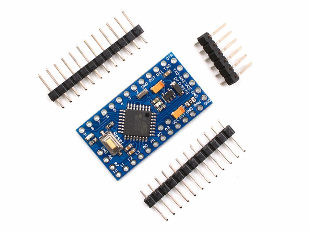

The question might be, is an UNO the best?
Have you seen the Arduino Pro Mini ~$3.00, (you would need a FTDI to program it)?
ot0tot:
I guess my question was whether the Arduino was overkill, but I think it's a good fit.
Thanks for the advice!
Once you add a display, an entry level Arduino with 328P (Uno, Nano, Micro) may be just right.
If you're handy with solder and have components, you can use the Arduino to program a bare 328P and DIY a board. Advantage is you get to keep your dev board and leave stand-alone chips in projects.
