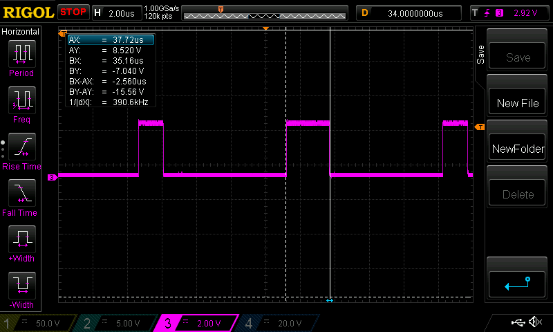

Just uploaded the following sketch for looking at the difference between
delayMicroseconds(1) vs NOP;
Oscilloscope shows 1.44μs during NOP; and 2.5μs during delayMicrosends(1)

You're spending a LOT more time doing the digitalWrites (and returning from and returning to loop()) than you are doing the delays. Writing to an output pin does not happen in zero time, especially when you use digitalWrite, which has relatively high overhead...
Also, IIRC, delayMicroseconds has a resolution of 4uSec.
