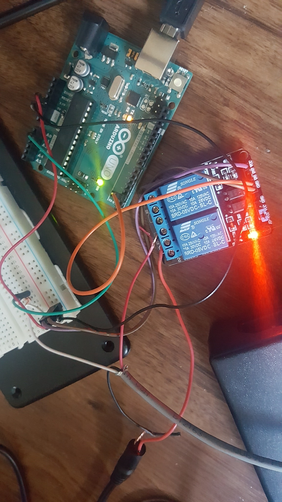

I'm trying to connect a piece of apparatus (a hoop type thing with sensors in it for fish to swim through) to an Arduino which is connected to a Visual Basic form with Firmata. The hoop is attached to a relay shield and an external wall power source (that goes up to 24V) and the Arduino. I connected like I connected a previous sensor. I had it so when that sensor reading went below 100, it would trigger rotation of a food drum in a feeder.
I'm unsure if I'm missing some code for the relay shield or if 24V is still not enough power for this. I attached a few photos (of the hoop with sensors and then of my connections), though they might not be too helpful. It's a bit of a mess.
Here's my code. I have IN1 from the relay shield attached to digital pin 2. I'm using the analog port A1 to take sensor readings from (white wire from sensor is connected there). Some pieces of the code refer to LEDs that aren't shown in the photos (I took them out to simplify the mess until I can get this sensor business working).
Any suggestions would be fantastic. Thank you! :smiley:

You need to supply more details on the sensor your using. Specifically what voltage it uses (24V ?), what voltage it puts out on it's signal wire (white) and what type of signal it puts out (analogue, digital etc).
Also can you describe the process the VB.net is trying to do in more detail.

I believe the voltage is either 20V or 28V. I got the hoop custom made from a laboratory equipment company. I had a very difficult time finding the voltage, but I was told tentatively that it would require 20V. Another lab I talked to that has this sensor said that it probably required 28V. I've gotten a lot of partial and unclear information, hence my confusion over the voltage.
I'm assuming it puts out an analog signal, but I'm honestly not for sure. It's a custom built piece and the company provided me with literally no information about it (except how to care for the plastic parts, of course!). I hooked it up like it was putting out an analog signal. I've also tried connecting it as if it would put out a digital signal.
The process in VB.NET is supposed to take continuous readings from the analog port / where the sensor is connected. I have it so it will loop and keep updating the readings.
Sorry I can't provide great information. I myself am working off very little information about this device myself. :confused: Thank you for the replies, though!

You really need to go back to the company and get the information you require if for no other reason than to prevent you damaging the sensor by connecting it with wrong voltages.
If you cannot supply details on the sensor then can you tell us what type of sensor it is?
I would guess it generates a small electric field that changes when a fish swims through it but only you can tell us for sure.
Does the sensor need AC or DC power and is the sensor output connected to the Arduino AC/DC and at what voltage. The Arduino pins can only handle DC voltages up to 5V so if the signal is AC and/or 20V+ then maybe something is damaged on the Arduino
