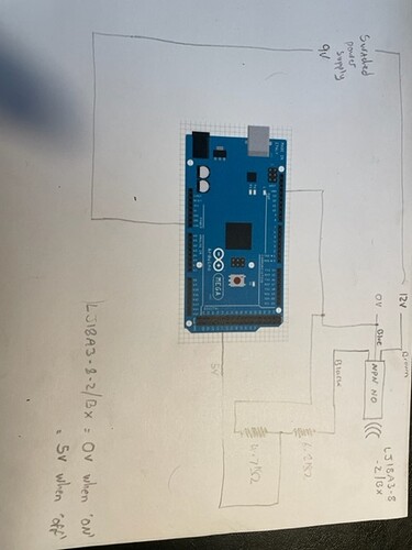

I'm using a Mega R3 coupled to an inductive proximity sensor (LJ18A3-8-/BX) to try and measure the rotations of a bale wrapping table. It works fine at slow revs (12 - 20rpm), but at full speed misses pulses / counts on the Arduino.
From the central shaft of the table to the point where the sensor and magnet are mounted (table radius) is about 1 meter. The magnet which passes in front of the sensor is roughly 30mm in diameter, and the table rotates at around 60 rpm. As such the sensor is only 'ON' for milli-seconds, but I know it is working at full speed as I can just see the red led flash on each rotation.
The sensor is 6-36 vin, so I'm powering it through a 12v supply and feeding the signal through a voltage divider, before going to the Mega (hand-drawn circuit diagram attached - apologies for quality).

The oscilloscope on the Mega input pin is showing a pulse signal, with the HIGH signal slightly over 5v. If the voltage is over 5v, would this cause the Mega to misread?
IMG_9782
I'm going to try using interrupts tomorrow, but I'm leaning more towards a hardware or wiring issue. Power source comes from a 12v tractor battery which when running produces 14v. The sensors are powered directly from this 12/14v. While the Arduino Vin power is regulated to 9v using an LM350.

I finally managed to get this working.
I used an additional voltage reg to smooth out the alternator voltage to a constant 12v. This supply I then ran to the proximity switches. I also put the pulse count code into a function:
  void count_rotations() {
  // read the pushbutton input pin:
  pRotate = digitalRead(pulseRotate);
  if (pRotate != pRotateLast) {
    if (pRotate == LOW) {
      intRotateCnt++;
    delay(50);
  pRotateLast = pRotate;
Then called this function multiple times within the loop, instead of just once at the start of the loop.
