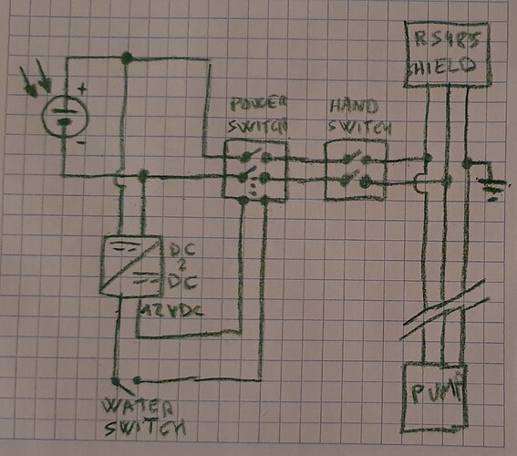

Based on what you have shown us you don't have any hardware with an RS485 interface. I see only a pump with power wires to it. Where do you think you connect the RS485 bus? It can't be the power wires, so it must be something else. I don't see the something else in anything you have shown us. Have I missed something?
A schematic showing all your hardware and how it is wired would make helping you a lot easier. Also show how you think the RS485 bus would be connected.
I cannot find documents in English, but this is the conection for the standard control device named CIU 273 SQFlex GRM. As you can see there is no other wire there than those for power.
I will try to draw the schematics, but I am still figuring out myself. The box is quite messed up and i am not sure if I am drawing it correctly.
From my understanding, there are the DC wires coming from the solar panels providing 82VDC and 11A maximum. Those fork in two to feed a 12VDC converter and the power terminals of a power switch ("contactor" in Spanish). The power switch is controlled by the output from the 12VDC converter that goes through a water level switch. After that power switch there is a mechanical switch that allows me to cut open all three wires, adding gnd there. Then the three wires into the pump. There is where I would connect my RS485 shield pins.
Will draw it anyway. But it will take me a while. Please, be patient.

Which confirms what I, @JohnLincoln and @Paul_KD7HB have said, the connection to the motor is not RS485, it is a something proprietary to Grundfos. In order to link it to RS485 you need their interface that provides an RS485 connection. RS485 does not connect to power wires, only to other RS485 devices.
