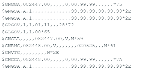

Hi everyone,
I just wanted to share a quick update and thank you all for your support.
The issue with the MKR GPS Shield turned out to be very simple in the end: the onboard 5V-to-3.3V regulator was faulty, so the GPS module was not powered at all. Once I bypassed the regulator and manually provided a clean 3.3V supply, everything came to life.
I connected pin 13 (TX from the GPS shield) to the GIGA R1 WiFi's RX pin, and now I'm successfully receiving NMEA sentences! (See attached image)
Thanks again for your help and advice throughout the troubleshooting.
By the way, do you know how I can determine from these NMEA sentences whether the GPS has acquired a fixed position or not? I’m currently monitoring the raw data but I'm unsure how to interpret that part.
the code that i used is :

> [@b\_b63](#):
Well clearly in the printout there is no latitude and longitude shown ($GPGGA and $GPRMC sentences) so the GPS does not have a fix.
The $GPGSV sentence is the one that reports satellites in view and signal strengths. The sentence shown indicates one satellite in view, but its very weak, so maybe the GPS is indoors or has a faulty antenna ?

Yes, the GPS is indoors, i will test it outside, i will send you the results !

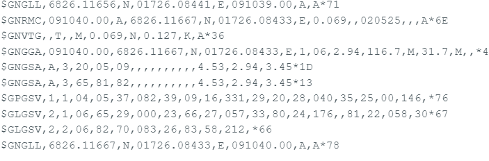

**Author:** ![b\_b63](https://dub1.discourse-cdn.com/arduino/user_avatar/forum.arduino.cc/b_b63/32/1214488_2.png) [@b\_b63](https://forum.arduino.cc/u/b_b63)\
**Post date:** [May 2, 2025, 9:18am UTC](https://forum.arduino.cc/t/mkr-gps-shield-dont-work-uart-communication/1377944/14 "2025-05-02T09:18:21Z")
</div>
I did the tests with the window open, normally I should have a fixed position.

> [@b\_b63](#):
Position variations are normal.
The GPS is reporting a position, however most all the the GPS satellites in view are reporting weak signals that are close to failure, next to a window is not the same as outdoors with a good view of the sky.

I'll try this another day, the weather is really bad today, thank you very much for your help. I think I'll manage from now on.
