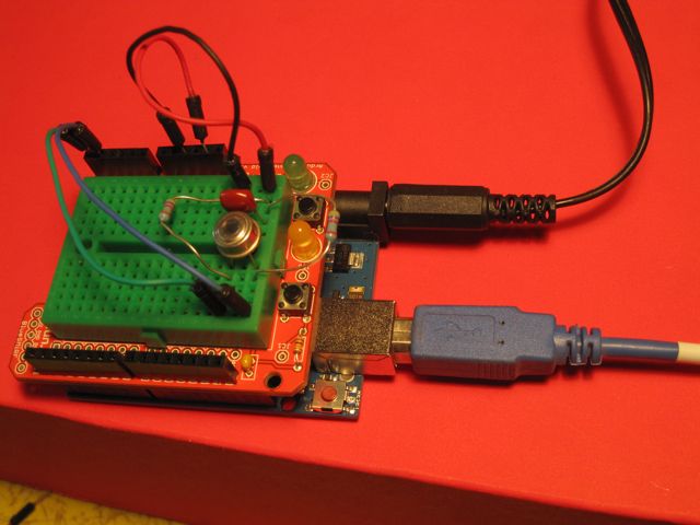

I just picked up a new Arduino R3, a Protoshield v2, and a MLX90614 BAA (infrared thermometer)
I have all the latest software (as of 2013). I have this thing wired exactly as its wired in the blog post http://bildr.org/2011/02/mlx90614-arduino/ and for some reason can't get any feedback on the serial monitor on my laptop.

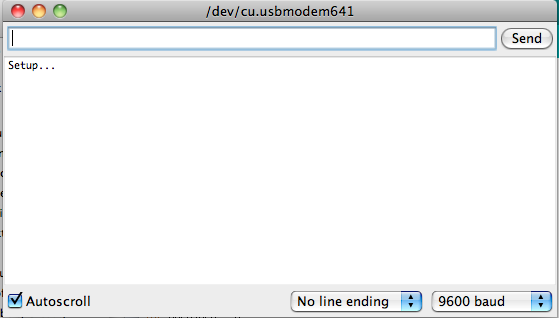

I open up the serial monitor once the board is booted up and all I get on the screen is " Setup..."
Just what's in the setup section... (Serial.println("Setup...");
Any ideas what is keeping me from temperature data from streaming on my monitor window??
I've checked the voltage and all the components on the board and they check okay.

Eventually I want to use this sensors data to provide feedback to this PID code I have currently working with a thermocouples analog feedback... Once I get it working.
Okay now I know my laptop and arduino + protoshield can communicate via serial because I just uploaded this script to test and it shows up on the serial window nicely....
I also adjust the baud rates accordingly to the code.

So.... it seems like its something between the sensor and the arduino/code. OR.... I could have a bad sensor. Is there a way to test it?
