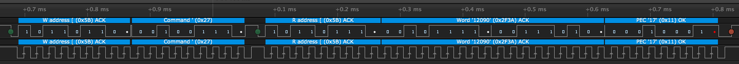

After wasting several hours reading other people's comments and code, I would like to make this writeup, which shows how to wire the MLX90615 IR temperature sensor and run the code on an Arduino Micro using SMBus (Similar to I2C).
Schematic
Look at the schematic picture.
Make sure to wire 4.7K resistors from the SDA/SCL lines up to the 3.3V output on the Arduino
Waveforms
I attached a screenshot of the waveforms. This was a successful transfer. Temperature was around 25'C.

My code (borrowed from others in the forum) works 100% with MLX90615SSG-DAA-000-TU
#include <i2cmaster.h>
Serial.println("Hello!");
i2c_init(); //Initialise the i2c bus
Serial.println("Return from i2c_init");
PORTC = (0 << SDA) | (0 << SCL);//disable pullups
analogReference(EXTERNAL); //setup 3.3V
int dev = 0x5B<<1; //Need to bit shift left. Someone said SMBus doesn't do this automatically.
int data_low = 0;
int data_high = 0;
int pec = 0;
i2c_start_wait(dev+I2C_WRITE);
i2c_write(0x27); //Alot of people make the command 0x07
//In the datasheet it says 0x27 on the wave picture, but 0x07 in the text; confusing!
i2c_rep_start(dev+I2C_READ);
data_low = i2c_readAck(); //Read 1 byte and then send ack
data_high = i2c_readAck(); //Read 1 byte and then send ack
pec = i2c_readNak();
i2c_stop();
