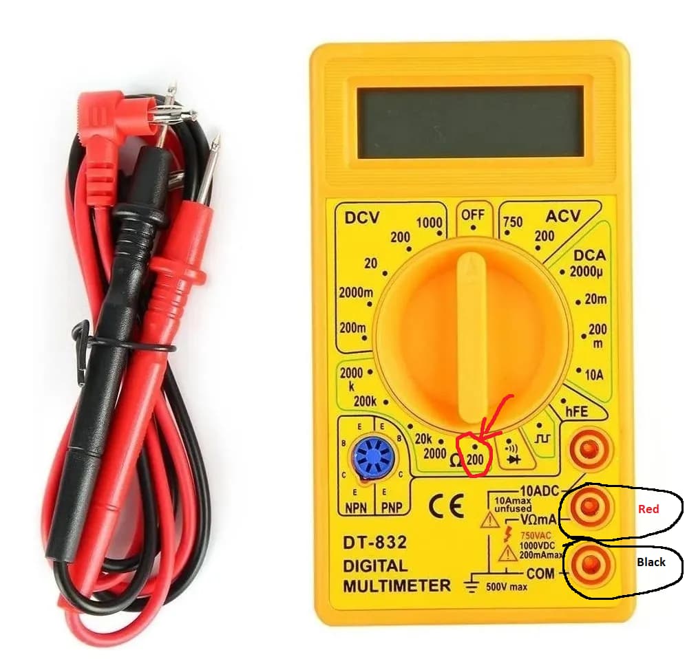

Stefan,
Honestly, I don't know if I measured it correctly.
I used a multimeter like this, set to 200 OHMs.
Below my scheme.
These values were obtained by placing the red probe on A and the black probe on B, on the MAX485 module.
Performing new measurements I noticed the following result:
Device + MAX485 = 130 OHMs (invert probe = The same but wavering more).
Device + MAX485 + USB INTERFACE (disabled from USB) = 66 OHMs (invert probe = same but wavering more).
Device + MAX485 + USB INTERFACE (enable on USB) = 190 OHMs (invert probe = -50 OHMs).
Another thing I noticed is that just by placing the multimeter in the max485 module, the measurement works. I take out the multimeter and the measurement stops.
