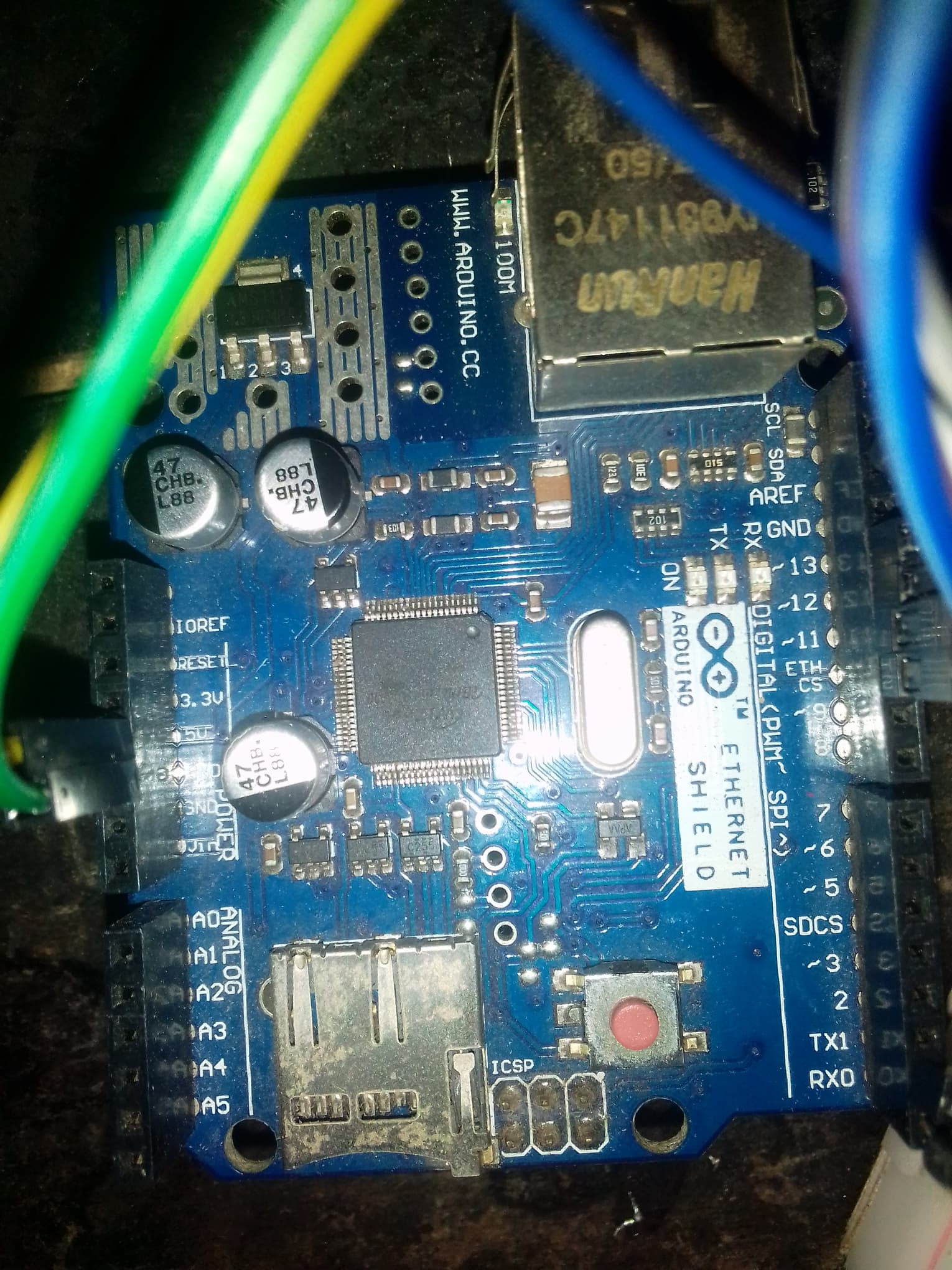

Smarmengol,huh? Well, thanks for the advice. I'll give it a try later but first, let's deal with the matter about the Ethernet Shield...
I've already tried to adapt the Arduino Ethernet Shield for Uno/Mega to the Nano (i both tried through ICSP and SPI pins), without any success... (The "no hardware" error)... Although the shield is working properly on Arduino Mega... Now that you're saying it should work, i may have done it wrong... Can you help me?
Maybe. Do you have an original Arduino Ethernet Shield or some look-a-like? How did you connect it to the Nano? I would use the ICSP pins for the SPI. What other pins did you connect?
I think that this is an original Arduino Ethernet Shield R3
I power both of Arduino Nano and the Ethernet Shield with USB from my laptop.
Also tried to connect the TX and RX pins, but with no success. The Ethernet Shield still couldn't be found.
Finally succeed. i had to both connect the ICSP header pins and the pins from 10 to 13.
The only D-pin you need is 10, the others are take from ICSP. You should also connect pin 4 to be able to disable the SD card reader (at least if you insert a card there).
In my case, if i only remove one of these connections, it wouldn't work...
You mean if you connect all the ICSP pins between the two boards and additionally D10 but no connection to pins D11 to D13 it doesn't work? In that case you have a broken board because these pins are connected on the Nano board and not used on the Arduino Ethernet Shield.
