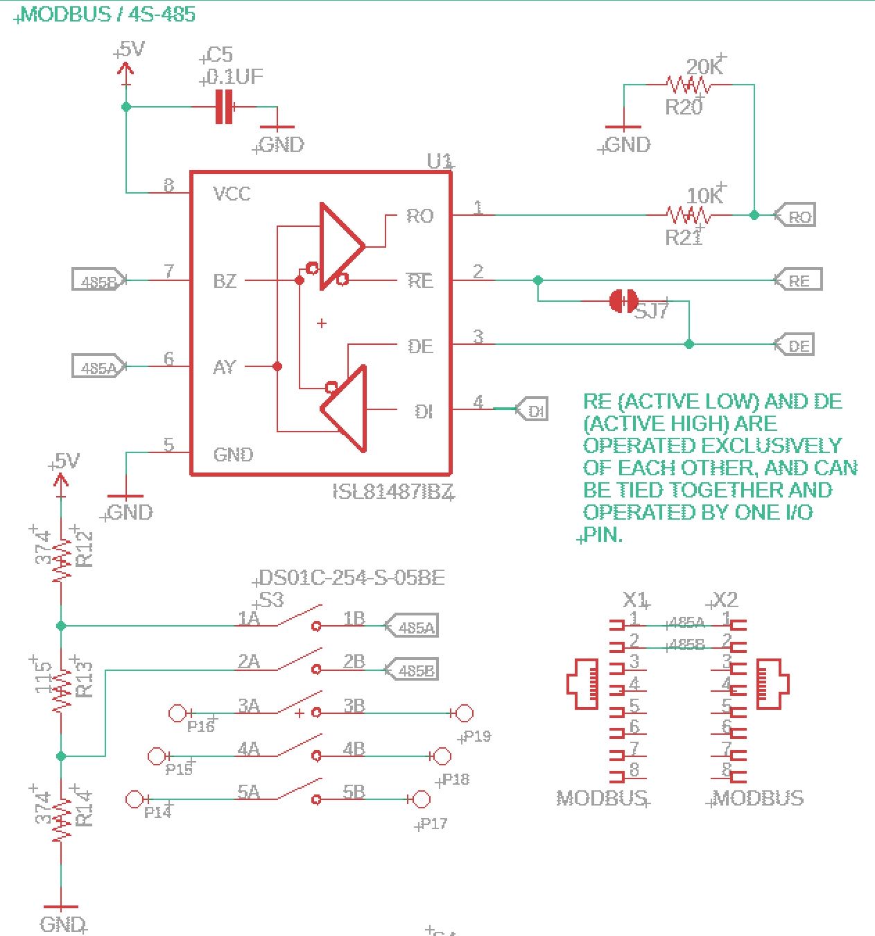

ModbusRTUSlave library and 32U4 not talking (solved: RS485 driver wiring issue)
Hi all,
I'm racking my brain trying to get a 32U4 (Itsy Bitsy 32u4 5V from Adafruit) to talk to Modbus (RS-485). I have an Uno here that I successfully got to talk, copied and pasted the code over to the 32u4 and made the required GPIO changes and serial port change (used Serial1 on pins 0 and 1), and basically the same code won't work on the 32u4. Specifically, as a test, I'm writing coil values to the slave device via the master, which is running on an Uno.
Here's the code that works on the Uno slave:

Here's the code that doesn't successfully communicate on my ItsyBitsy 32U4:
#include <ModbusRTUSlave.h>
const byte potPins[2] = {A0, A1};
const byte buttonPins[2] = {7, 8};
const byte ledPin = 13;
const byte dePin = 9;
ModbusRTUSlave modbus(Serial1); // serial port, driver enable pin for rs-485

and here's what I'm running on my master:

I'm using a custom circuit for the RS-485 transceiver, which I screwed up in two ways, and have since fixed: I had R20 and R21 there to make it 3.3V compatible for a previous project (R20 is removed, R21 is shorted now), and I added a pullup to the DE pin. I do have DE and REn solder jumpered. I've also tried it with and without R13 (terminator) resistor switched into the circuit. R12 and R14 are not populated. All of these boards are on a common power ground. I did put a scope on pin 0, and there's data flowing in.
Any suggestions?
Thanks!
-Rodney
Well, I figured it out, but I think I'll leave this information here if it looks useful. Lessons learned:
  1. Tying DE and REn together and operating them as one pin works.
  2. DE/REn needs a 10k pullup.
  3. I had reversed my RS485 A and B wires during troubleshooting and didn't swap them back. I had fixed the DE pullup and when it didn't fix the problem, I wrote my original post. I then realized my A and B wires were crossed and BAM it worked.
Thanks!
-Rodney
