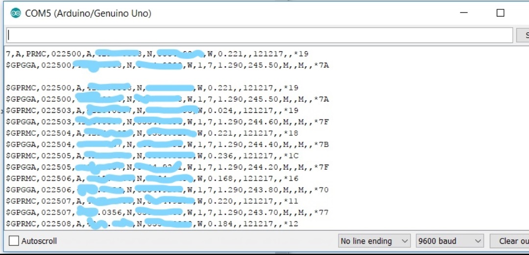

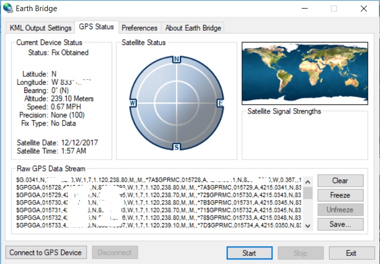

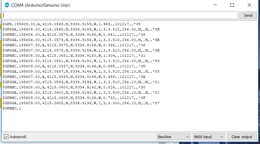

Hey, so a quick update.
The new GPS unit came in today. Realized I never did fry the last one. Just crappy signal and terrible noob mistakes lead to me getting garbled data.
Updated my code today and everything looks to be working well. Data is sent via the HC12 to the remote arduino.

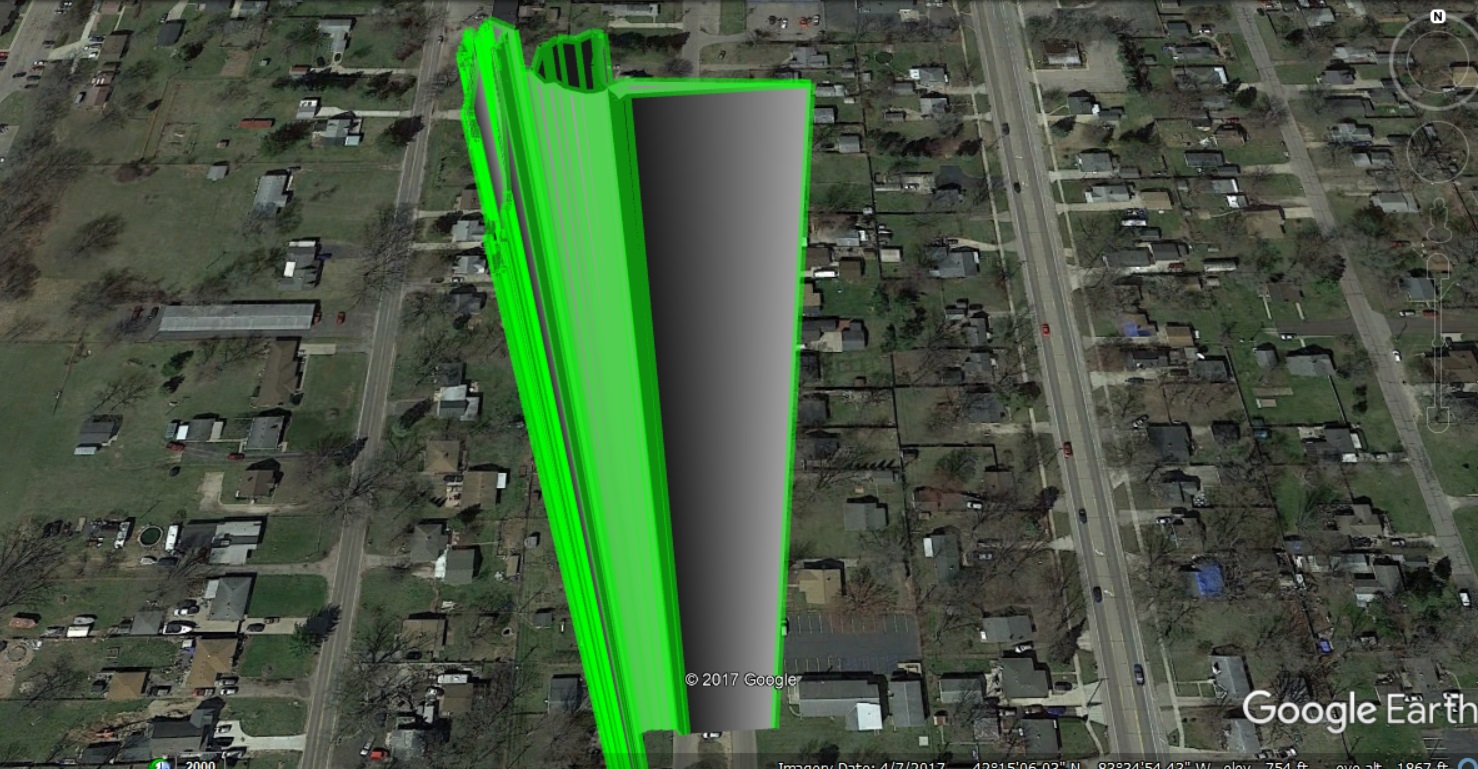

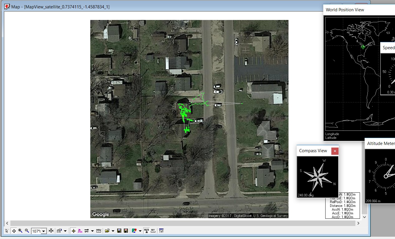

I do have one drawback though. When receiving the data on the other side and even before sending and checking things out in serial, it seems that I am printing to serial with no \n
When I go into my earth bridge software, It looks like all the data is transmitting on one line. When attempting to add \n into the receiving side, the real time tracking still doesnt work but I will play around with it a little more.
Ordering an antenna to make this easier while inside. Here is the updated code with help from /dev

I don't see the current system configuration, so I don't know what the receiving HC-12 is connected to... but if it connected to an Arduino, you should not be sending the NMEA sentences. As I have said multiple times, just send the fix structure (31 bytes) instead of ~150 bytes of two reconstructed NMEA sentences. It's doubly silly to parse the raw characters and then send a reconstructed version.
The whole point of providing you with the NMEAprint routines was so that you could send fix structures Over The Air and then emit reconstructed NMEA sentences at the receiver. Instead of this:
  while (gps.available()) {
    fix = gps.read();
    NMEAprintRMC( &DEBUG_PORT, fix );  // These could be too much to print!
    NMEAprintGGA( &DEBUG_PORT, fix );  //   This will delay your sketch by about 90ms.
    NMEAprintRMC( &HC12, fix );             //  Don't send raw NMEA!  This will also delay your sketch.
    NMEAprintGGA( &HC12, fix );
... just do this on the transmitter:
    fix = gps.read();
    HC12.print( F("FIX=") );               // A "start marker" that the receiver can watch for...
    HC12.write( (uint8_t *) &fix, sizeof(fix) );     // Transmit binary structure to remote
This short message will not delay your sketch at all. The message will be sent in the background, and your sketch can continue to do other things.
  • NOTE: You can add all kinds of things to make this short transmission more reliable, since the HC12 doesn't do that for you. Checksums, error detection and correction codes, go crazy.On the receiver, you simply read the 31 bytes into a fix structure after receiving the special "FIX=" start marker. Then use the NMEAprint routines to emit the reconstructed NMEA sentences. Something like this on the receiver:

This is similar to the Serial Input Basics tutorial in that it watches for a special start string and then gradually accumulates bytes (in the fix memory bytes). When the required count of bytes has been received, the fix structure has been completely filled out. No NMEA parsing required, because all of that was performed at the transmitter. The fix structure can be used for whatever purpose at the receiver, including recreating the original (verbose) NMEA character stream.
Both NMEAprint routines use the same method to print CR/LF (aka '\r' and '\n'), so the HC12 transmission might be dropping a byte. I don't see any receiver code (or the system connections), so I can't suggest why a LF is being dropped somewhere. Of course, adding some kind of error detection to the transmitted message would have told you for sure... :-/
Image embedded for our convenience:
Technique described here. In the future, just select the text in the Serial Monitor window, then copy and paste it into a code block in your post.
The first line shows that characters are being dropped. I don't mean that in a bad way, just that the HC-12 does not have its own error detection and correction. Bytes just get corrupted (i.e. lost). Maybe the LF is being dropped consistently.

Finally, here's an update.. have everything hooked up. This time I got some pictures, updated the code, the whole shebang. I'm still getting some strange output in certain softwares, such as EarthBridge. It seems as though it can't read the sentences accurately. It outputs them on one line over and over until a new line. If I were to just output the raw data, no libraries, it would work but I'm guessing it doesn't like the way it is printed to serial.
Weirdly enough, if I use u-blox u-center , it displays everything just like it should. The real-time tracking is a little outdated compared to google earth but I can deal with that. I get what I want at least, which is; it does real-time tracking and it supports exporting the data to KML to display on GE. Although. the altitude seems to be way off, even when outside with a valid lock. Not sure what screwed that up?
u-blox software
GE Pro
Other than that, I am getting some pretty good data on the other side. Every once in awhile I will get corrupt data or a random, incomplete sentence only when closing serial for some time then reopening after maybe a few minutes or so. Doesn't do it if I just close and open quickly.

Here are some pictures of the setup as it is now. I haven't made any final connections as of yet. That will come soon when my PCB board gets here and also my 3D printer. I will probably switch to an arduino nano for the final build. I could send the uno into space but it is a great practice board.

Looking good!
240m is about right for your location. What were you expecting? Perhaps GE is showing alt=0 for the imagery. You may need to use "geoid height" if GE shows the imagery at geoid height=0.
Error Detection and Correction...
The Arduino keeps babbling while the Serial Monitor window is closed. You might be reopening the Serial Monitor window when the Arduino is in the middle of a print.

Thanks! Thanks for the help with the code. I will def make sure it stays public and available to anyone who wants it. sharing is caring
-dev:
I don't know why but that whisper thing was funny :smiley: and as far as the altitude, I was expecting it to be closer to the ground haha, but that is no big deal. I will just add in the code somewhere to remove 200 meters when printing to serial. It's ok though as it isn't a big deal that it is off.
Now all I need to do is order some lora modules and assemble the rocket and final circuit.
