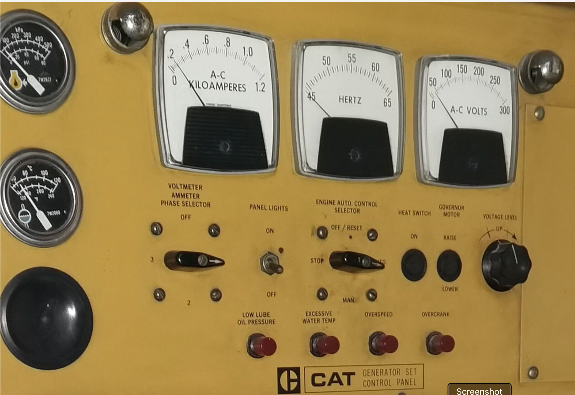

let’s assume that the digital unit is RS485 so there is no need for an Arduino.
That leaves us with the Analog panel unit.
The left gauge appears to be oil pressure over water temperature.
The main electrical gauges are [ unknown], HZ and Volts AC
the left most electrical gauge is labeled. 0 to 1.2. I would have guesses AMPS, then then expect reading more in line with 0-120 amps or some such. Volts is labeled 0-300 so we know they can put the 0’s on the readings.
there are some idiot lights on the bottom, low oil pressure, high water temperature, overspeed and over crank.
Not knowing for sure, but the left most selector switch appears to select what is displayed on at least one of the meters.
Phase selector. That would indicate the generator might have a 3-phase output.
That makes sense that you could check volts and amps on each phase
so, the wiring diagram would be needed to explain what the selector switch would be for.
The second selector switch is for ‘engine auto control selector’ settings of off/reset – Auto, Manual, Stop can be selected. Since the OP said this project is observation only, there is no remote control, then that switch may or may not need to be monitored.
There appears to be two switches heat switch and governor motor, but both appear to be optional with caps over the holes.
The last adjustment is a POT with an adjustment for voltage. Assuming this is a large generator and therefor stationary, one might assume that driving a load that is far away, one might want to output 260 volts to get 240 at the load. Or, if the load is close, drop the output to 240.
that leaves the two panel lights on the top, on either side of the gauges and the capped hole for another pressure/sensor gauge.

the digital panel is all the same readouts with the addition of a display. hours/battery, etc.
the OP intentionally blocked the panel labels so we cannot try to find schematics.

@dave-in-nj , sorry for the bad pictures. The "unknown gauge" is "kilo-Amperes" this is a shot with better angle:
All your deductions are correct (I'm not sure about that the digital unit is RS485) .
