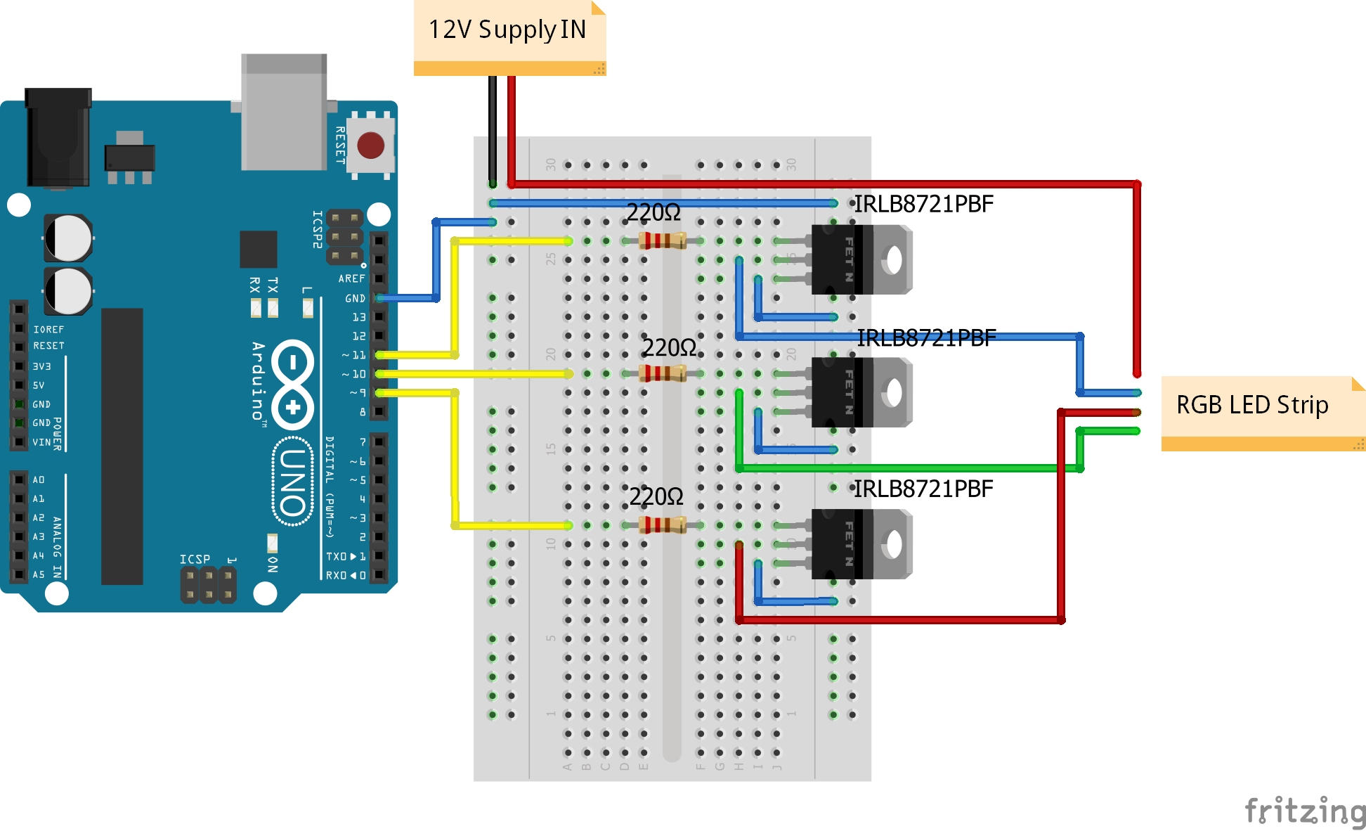

Hi again,
I've purchased the items and I did a little test run last night. I've had to add in some 220 ohm resistors because the LED's was just showing ever so slightly. Would anybody please mind taking a look at my design and tell me if I'm on the right steps? I've noticed people placing resistors between ground and the gate pin. I'm also hoping the 220 ohm I've used is the correct value required.
Thanks!
Keep power and ground for the strip separately wired from the Arduino.
Sure Arduino ground has to be common to the LED ground, but don't route
ground currents through the Arduino board like your diagram. Just have one
wire linking Arduino ground to the high-current ground near the FETs.
Hi Mark,
I assume you mean the following (attached diagram) when you mean keeping them separately.
Is there any reason why I can't / shouldn't use the 12V supply to power the Arduino, and run it from ground/vin? Or is it just due to the amount of current that would be passing through the Arduino board?
Thanks again.
I'm just revisiting this.
Realistically, I want to be able to only have one power supply for the Arduino, and would like to use the 12V supply I already have coming in. I've attached another Diagram. Would this one be ok? I've attached the Fritzing file also.
Thanks again.

Hi xerof,
You need a 100K resistor between the gate and GND, to pull the gate low, this will ensure that the FETS are OFF until you apply your signal from the Arduino.. Something like 220R is usually from the arduino pin to the gate, just to limit gate current but that is usually very low anyway, perhaps more to protect the Arduino output!! just in case?
