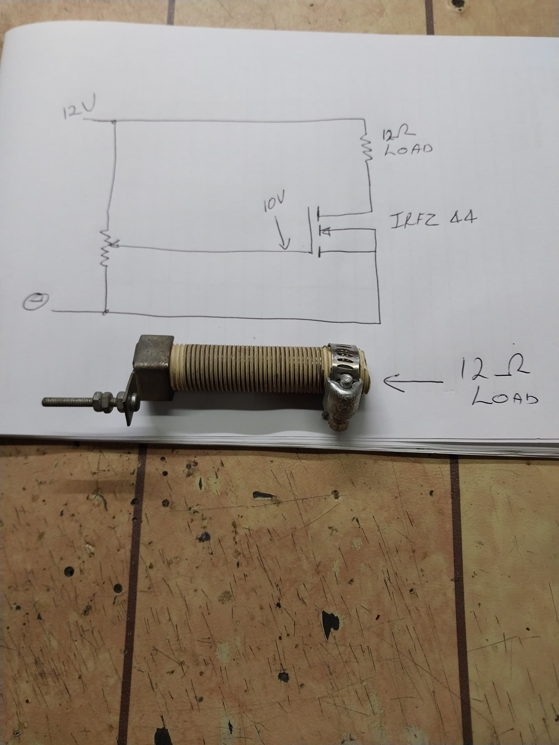

Hi Everyone.
I did a test on a IFRZ44 Mosfet and measure a voltage of 1.5V across the Drain and Source when the Mosfet is supposed to be fully switched on and the amps thru the Load is 900mA.
Rds(on) is 10V and the Drain Source resistance should be 0.022 OHM but this is not what I found.
When I short the Drain and Source the Load now draws 1A on 12v .
What did I do wrong?
Thanks for replying.
This is my test circuit.
When the gate is at 0v is the load current at 0A ?
When the gate is at 12v is the load current at 1A ?

When the Gate is 0V the load current is 0A.
When the GATE is 12V the load current increase a little but when I short the D and S the load current is 1A so there is voltage lost over D and S junction.
Gate is 12V and voltage across D and S is 1.48V.
it seems to me that the mosfet is defective or fake
12V - 1.48V = 10.52V
Current should then be = 10.52 ÷ 12 Ω = 877mA

With my multimeter in series on the 20A Scale I get 880mA.

Show photo of the circuit. Either the MOSFET is damaged or your circuit does not match your schematic.
How about some photos? You managed one.. if you do that, so many replies won't be necessary. :slight_smile:
Can kill a mosfet.
12V on multimeter is the gate voltage -blue wire
Neg from psu to source - white wire
Drain to load - red wire
Hope this helps.
GMT +2 here , will continue tomorrow.
That's a strange looking pot. Did you confirm the pin outs?
Those thin crocodile wires may be the reason. Did you try to measure directly at MOSFET pins? I can imagine the wires drop 1.5 V carrying 1 A.

I did measure direct on the Mosfet pins and I did mention that shorting out the D and S the amps go up to 1A.So the drop in the wires is not causing the lost ,the lost is1.5V direct over the mosfet D and S.
Update:
I replaced the IFRZ44 twice with new ones and get the same result.
Then I replace the IFRZ44 with IRF3205 and now I get 1A thru the load with only 10mV Loss over the D and S.

Showing your test setup is working fine, but the "IFRZ44" MOSFETS are not working as they should.
So I cant see any answer other than they are faulty or they are another type that is incorrectly marked.
It appears you are using the POT to "sweep" the gate voltage from 0 to 12V. However doing this there will be a period the MOSFET is in its linear range. When it is this mode, the power dissipated in the MOSFET could be as much as 6V * 0.5A = 3 watts. This will likely make the MOSFET hot (and not happy) I can't say if it will damage the device but is is not a good condition.
You should use a switch to control the gate.
