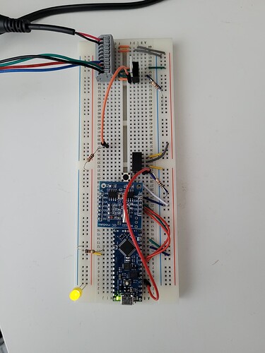

The whole business with touching it influencing how it works suggests a connection/cabling issue. Could you post a good photo of your setup?
I don't think it makes any difference. Still completely off with the 10k resistor in place, and susceptible to touch without it. Here are some pics:
Not included in the diagram are a button (used for turning the D2 PWM pin on and off) and a clock module that is connected, but not controlling anything right now.
OK, well, the 1k now forms a voltage divider with the 10k, so you only get 90% of the available output voltage of the GPIO pin on the MOSFET gate. Swap them so that the 10k goes from GPIO to GND and then take 1k from there to gate. Or just leave out the 1k altogether. Since the 10k is also not strictly necessary, you could try without either of these resistors.
Your led looks pretty happy now where it is with its new-found resistor friend :slight_smile:
Given what you said about touching the Arduino, I suspect it might just be a bad contact on the breadboard. Have you tried moving the Arduino to the other end of the board, or shifting it by a few pins? Sometimes those strips inside the breadboards become a little...well, compromised.
