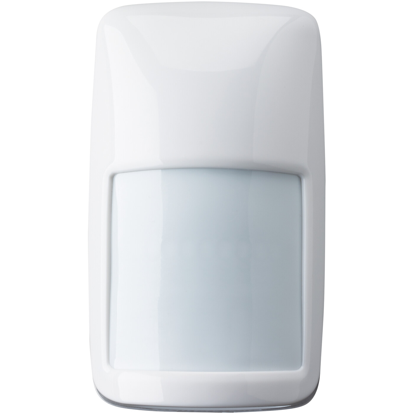

I don't normally post these but gonna take a shot in the dark here, I'm looking for a motion detector that can be used with an arduino, Now I know most of you would slap me upside the head and say hey dummy go google it. I have, found numerous ones but not exactly the kind i'm looking for. I'm looking for an enclosed motion detector that is also adaptable for 5V logic.
Something like this is what i'm going for. I do know that adafruit sells PIR motion sensors already capable but i'm going for something a bit cleaner. If anyone has any leads or brands that you KNOW would be worth trying, please do let me know.

Buy a cheap motion sensor that looks like your picture and use it. What the problem?
Paul
The one in the picture does seem like one you can use. I think the issue you are having is that you need an obvious way to interface 5V logic. Unfortunately, if you are not buying a hobby product, all you have are commercial ones.
My advice to you is to buy whatever motion detector that meets your specs. Luckily for you, pretty much all motion detectors have "dry" contacts, meaning, that nothing is connected to it and is really just a relay being switched on and off for you. For this contact, envision it being like the push button in this page

I think these all have a relay closure to signal an alarm
https://us.boschsecurity.com/en/products/intrusionalarmsystems/detectorsandaccessories/motionpir/motionpir_4897
You can cover a room, I think there is one that make like a floor to ceiling curtain, etc.

what's wrong with the simple Passive InfraRed sensor boards sold by adafruit and ebay and the like? The sensing parts all work the same and the PIR boards are already tapped to send a 5V output (ie: interface with an arduino)...
if you just want it to look pretty, build an enclosure for it.

Interesting! I never knew about the mercury contacts. I was referring to the indication that it is "volt-free", for lack of a better term.
