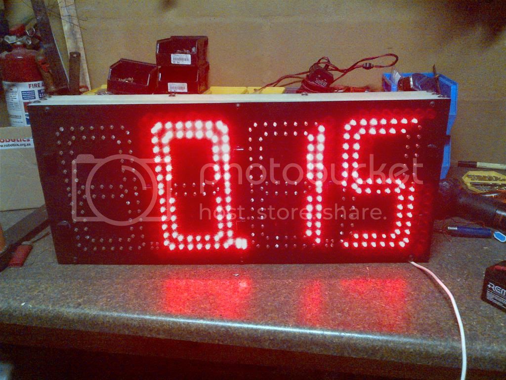

So the First thing was to build a big ass Seven Segment Display. i used 5mm LED's and 360 of them haha. the Display is about 10 inches high by about 32 inches wide. It has 4 digits and decimals as well. The next thing was to drive the Display. What a learning curve.

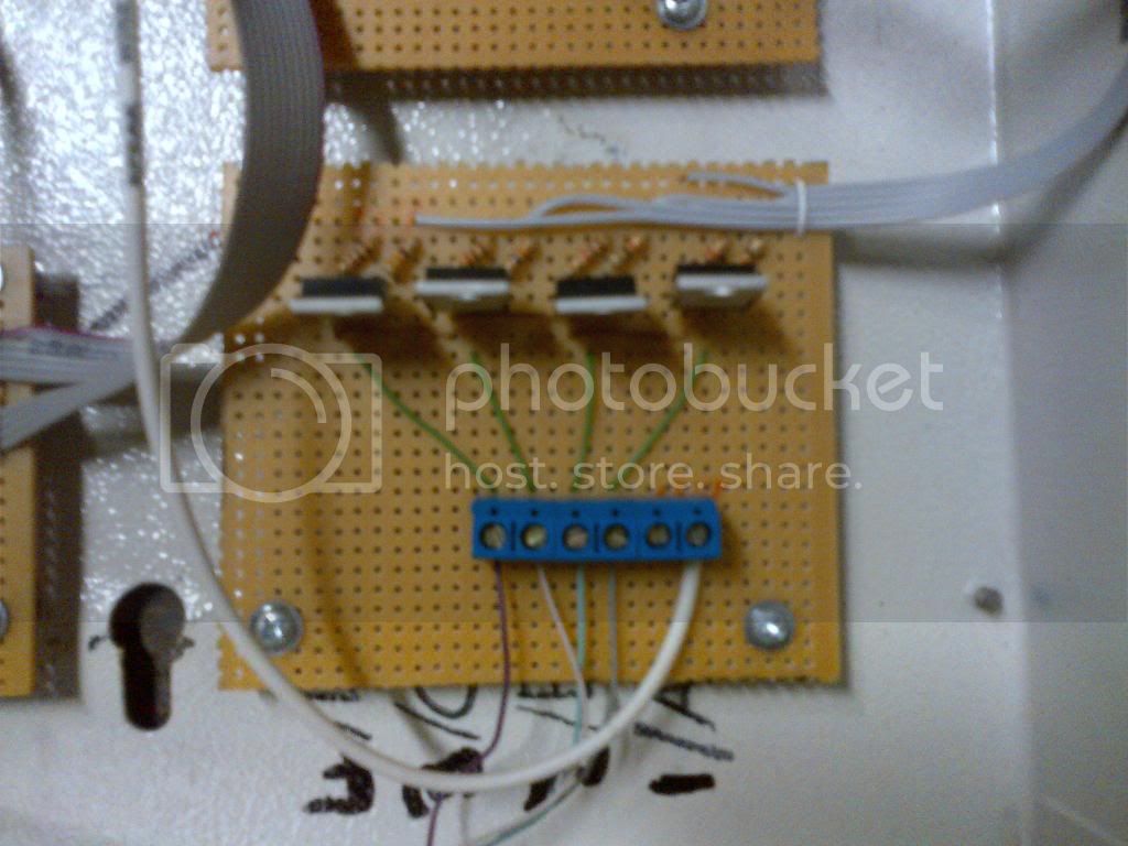

The next brick wall i hit was that the microcontroller can only put out so much current and i panicked again!!!!!!!!!!!1 but then i hit google and discovered the world of transistors and mosfets!!!!!!!!! YAY!
So then i found out that i need to do high side switching and i need to use n channel mosfets or npn transistors to drive p channel mosfets or pnp transistors!!!!!!!! i was like HUH!!!!!!????????

Here are some pictures of my project
The Display

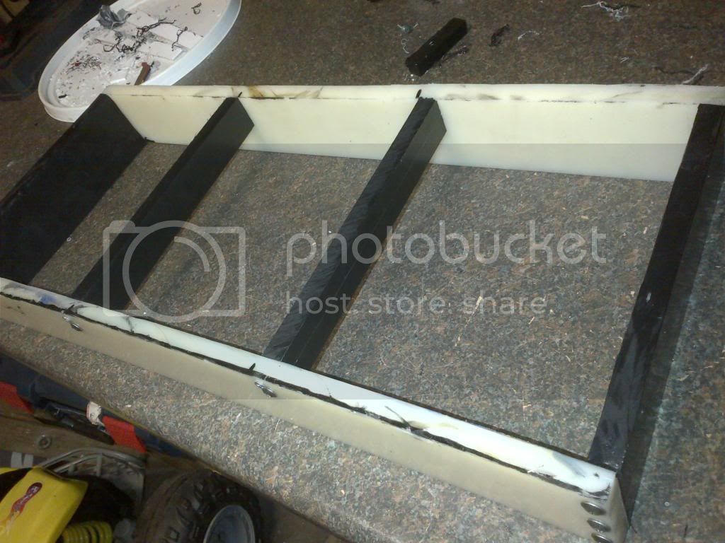

The Display frame
The Control Box with all the electronics
High side switching

Display with LED's in displaying 15 seconds

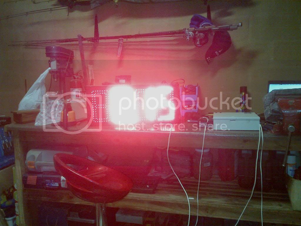

viewing display headon (the LED's have a 20 degree viewing angel and are very bright if you within the angle. The photo is a complete blur but the human eye can read it perfectly. very bright.
